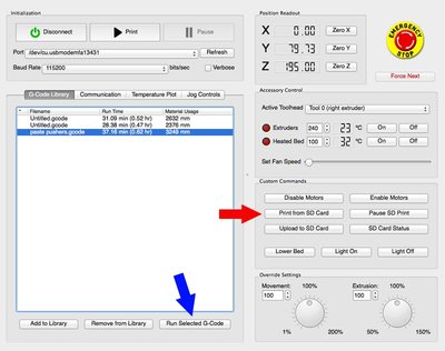

A few Questions.....
First - When the printer stops is it always on the same print file? (If it's the same file every time that file may be corrupt.) Try printing a different file and see what happens?
If it still stops on a different file it might be a Computer/USB cable problem.
The best way to tell if it's a computer/USB cable problem is to print directly from the SD Card. Start the print with the "Print from SD Card" Button (red arrow) and once it starts printing unplug the USB cable from the computer. If the print stops at any point after that you have some other kind of problem.
(Note- If your starting the print from the other button (blue arrow) your not really printing from the SD Card.
