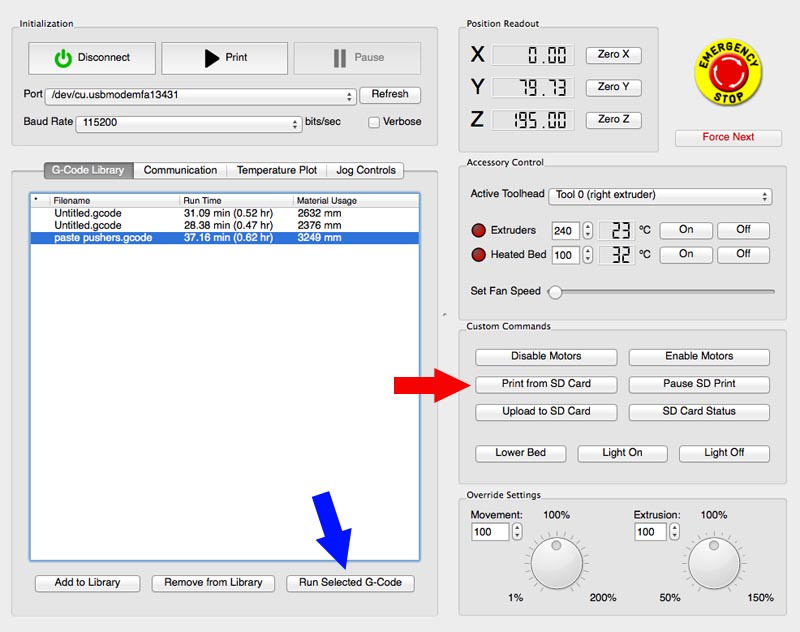

For example with one print it was .gcode with everything customized in slic3r with appropriate settings for MakerGear M2 24V V4 Hotend via SD Card and the print stopped printing a planter/vase about 5% into the print as I noticed on Simplify3D, the X, Y, & Z coordinates weren't moving and my extruder as well as heated bed were at 29 degrees celsius, normally at 215 and 70 respectively.
Another example I was printing via USB with same settings above minus the SD Card and the odd part of this is the printer paused about 20% into printing the vase/planter which was an .STL file but the X, Y, Z coordinates were rapidly changing as if it were still printing but the MakerGear M2 was in-fact paused while the bed and the extruder were actually still heated at 215 and 70 degrees celsius.
