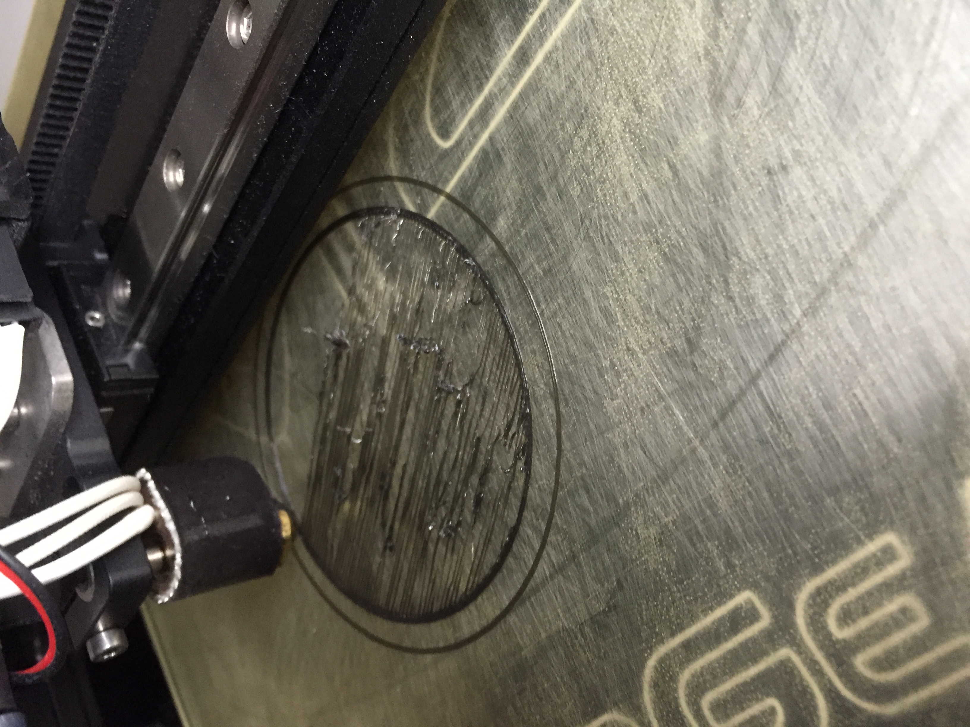

I was having a problem with the first layers of my print,
I have adjusted to .15 mm and it seems that I am having the same problem, what do you think I should do? Increase gap?
printing with eSun PLA on PEI sheet
see image, thanks!
see image, thanks!
Re: adjusting gap
Is that supposed to be solid fill inside that circle?
It doesn't look like the filament is sticking, which is a sign of the gap being too large now.
You might have to reset the gap. (Make sure you retract the filament all the way out and clean off the tip of the nozzle completely before setting the gap - a little drip of hard plastic on the end of the nozzle can set the gap too large.)
Re: adjusting gap
thanks Jules, I recalibrate, and also cleaned up the stl. all ok now!Jules wrote:Is that supposed to be solid fill inside that circle?![]()
