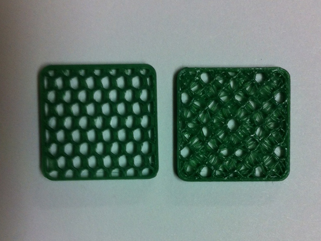

Yes, I saw it happen once early this morning. I was just printing calibration squares at the time (2 on the board), so I figured I must have done something wrong, or something got knocked loose.
But since then, I've also seen two strange slicing phenomena.... Both were unusual patterns that were supposed to be the Fast Honeycomb. Neither one looked like a honeycomb, one of them that I actually printed is rather pretty and looks like a mandala, and subsequent slices were fine. On the mandala one though, the odd thing is that the bottom two layers did look like the Fast Honeycomb pattern. So there's sumpin' goin' on. It's like S3D is just suddenly deciding to do it's own thing. (Could be additional settings that i'm not familiar with yet though, so i'm reserving judgement until I'm sure.)
