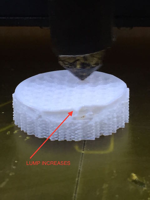

I just tried another print, and it looks like after I increased the support density and adjusted to 3 layers, the support actually seems to be working, however what I am seeing is the outer wall collapsing ? in this picture you can see a lump, this outer wall is actually higher than the rest of the print....

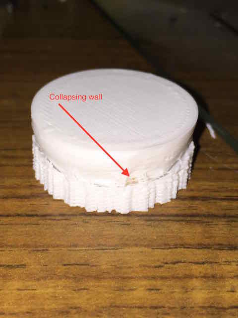

A little worse, more collapsing....

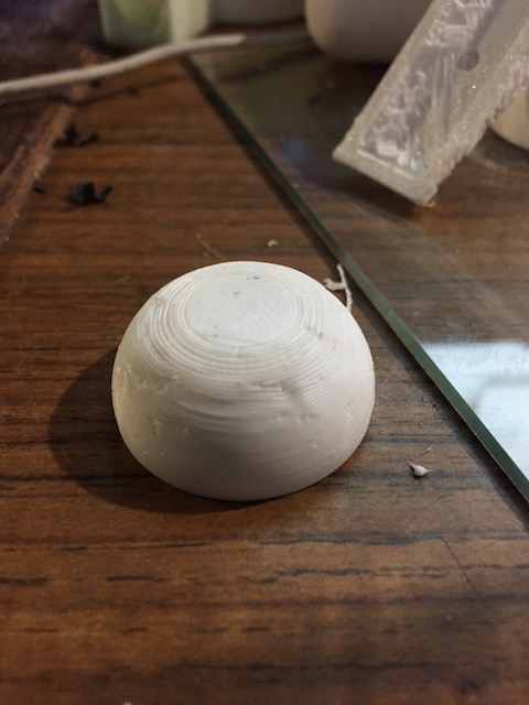

Then, after a few more layers that lump goes away...

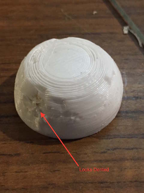

and you wind up with dented looking surface....

those are all heat issues. the parts is heat soaked and soft. you need to print that with something else to increase layer time and allow for the part to cool and solidify between layers.
