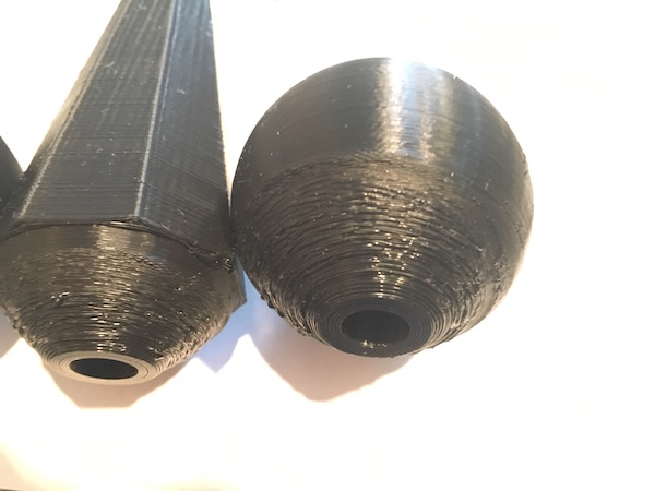

I'm trying to print Megabot from Big Hero 6 for my daughter.
http://www.thingiverse.com/thing:963917
First attempt I printed the file that prints all the parts at once. Three spheres and six other pieces that have a sphere shaped base. Bottom halves of the sphere shapes printed like this..

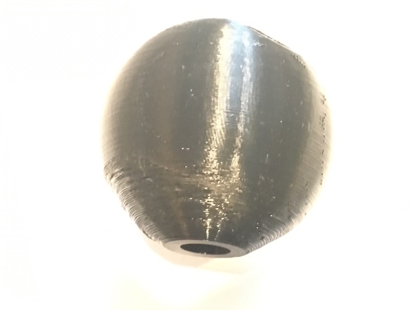

Top halves are perfect, even on the full spheres. I figured they printed this way due to nine parts being printed at once. After a layer, each part had time to sit and cool, causing the poor quality. So I tried printing one piece at a time...
One side of the bottom half came out nice, other side same as the nine piece batch.
What can I do to get the bottom half print quality better, if anything?

Spheres are always a bear. It's just too much of an unsupported overhang. Printing with support will help, but only to an extent, as you need a lot of support for the worst overhangs, and then you'll get some loss of quality where the supports connect to the print. The best thing to do, really, is to print them in halves and glue them together. A tiny seam around the middle beats a horribly messy bottom half any day.
Re: Horrible quality on bottom half of sphere shapes...
Indeed! Cut the spherical parts horizontally along the equator, add alignment pins, and you'll never even notice the seam... because it'll look exactly like the horizontal layer lines.Tim wrote:print them in halves and glue them together

I've learned overhanging inclines at anything more than 45 degrees will always be a bear due to lack of adequate underlying support. Which happens to correspond to half the bottom of the circle.
What I'd do: Print two top halves separately and affix them.
