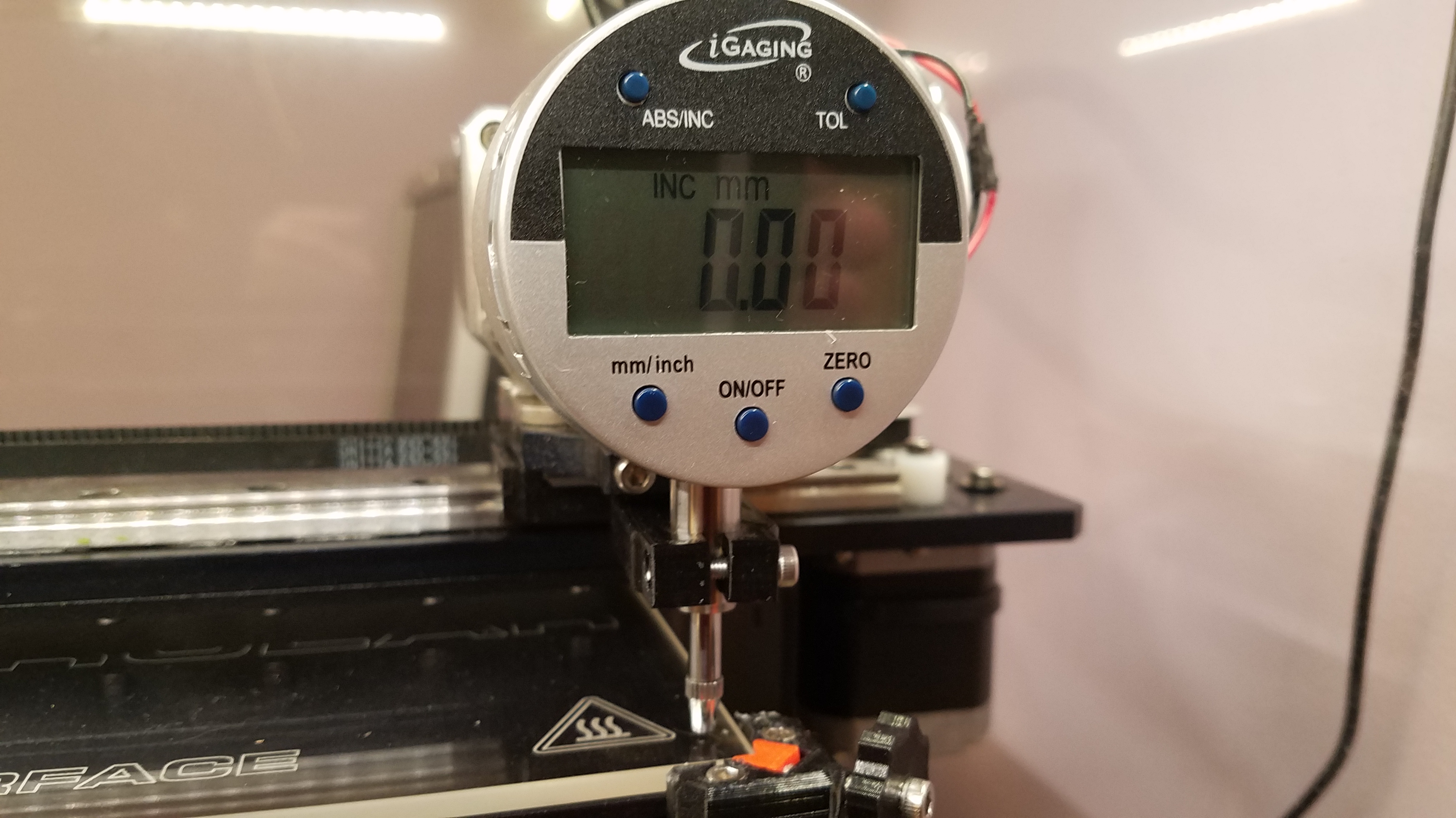

dail indicator mounted where the hot end lives works real well for physical leveling...
