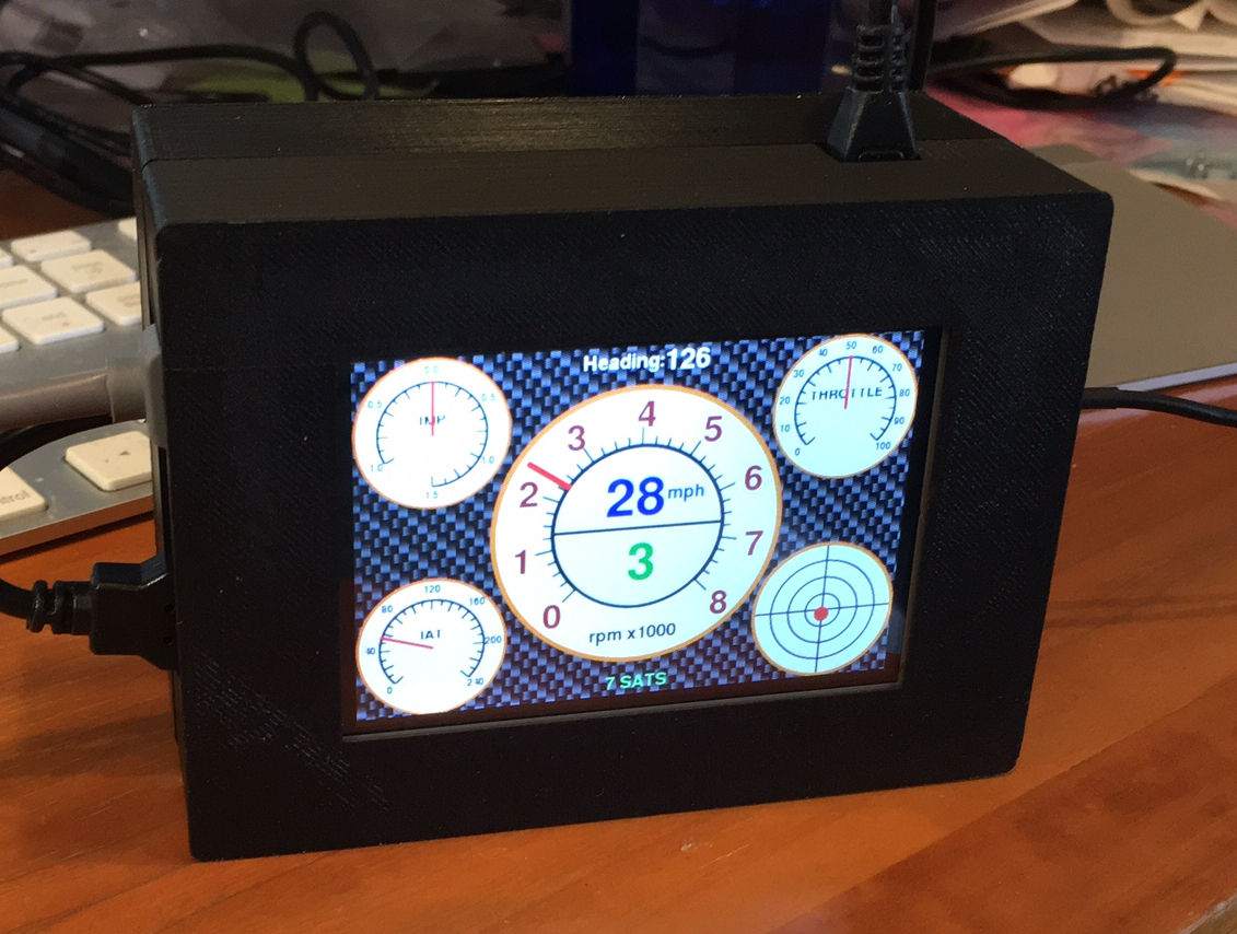

The print is composed of 4 pieces: the front and back shells, plus two pieces which serve to hold the LCD touchscreen in place and support the Raspberry Pi (which mates through a connector to the LCD screen) in the proper place. There's also a 3-axis accelerometer/compass/gyro board (currently mounted on the back of the LCD display) and a GPS receiver in the case. In one photo below the second revision of the shell has the support pieces printed in red filament.

Thanks! Before getting the MakerGear, I had to find an existing blank enclosure that was about the right size, then dremel the openings for the LCD, connectors, glue in nylon screws as mounting studs, etc. Time consuming, not a lot of fun, and in the end not very pretty. Now I can fit all the parts into one enclosure neatly, and have room left over for a breadboard for prototyping new hardware. And I can make another in four hours without doing any cutting, drilling, or gluing.

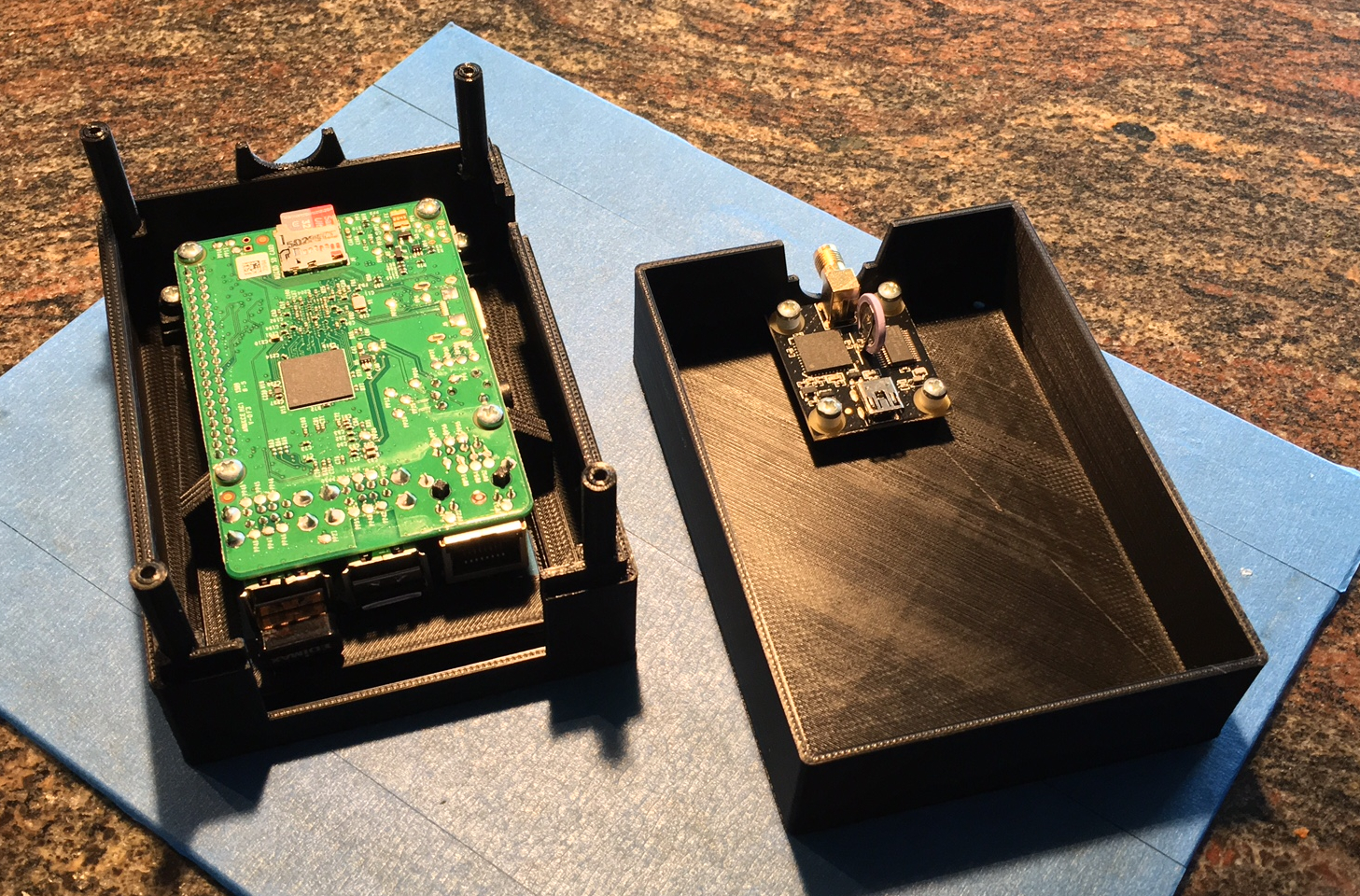

Revised version of the enclosure: now with the breadboard installed (and 3-axis accelerometer/gyro/compass moved there) and reoriented GPS receiver. When closed, the box is 4.5" x 3.5" x 2.25"
