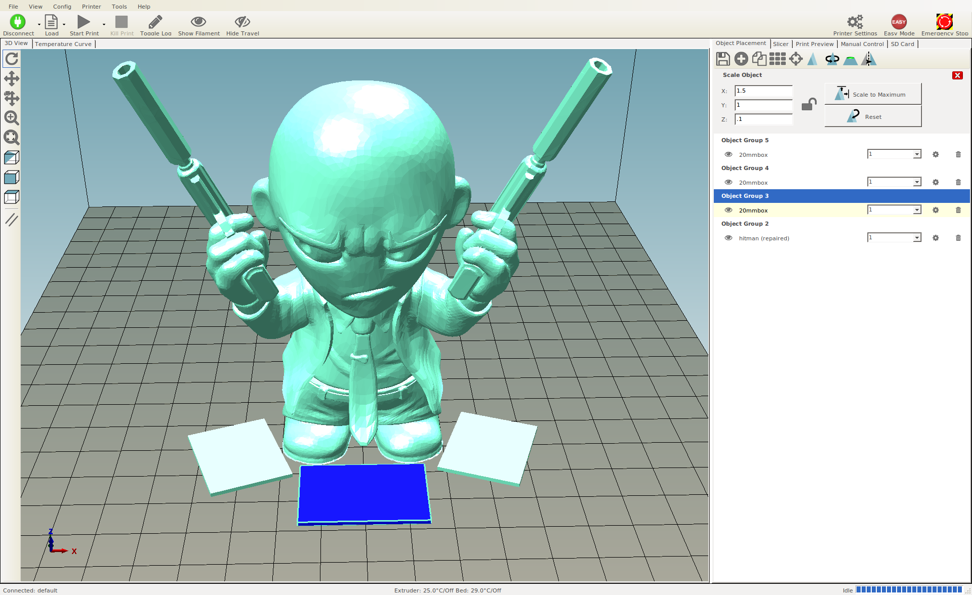

Unfortunately, my first couple of attempts failed with the support toppling so I decided to add some manual rafts in repetierHost with the arrangement looking like:
Specifically, I just added an arbitrary 20mm cube and rescaled and rotated until they were roughly under the generated supports. I've tried using a brim with similar models in the past, but had limited success.
Is this just me, or do others have similar issues? Seems to me that it would work fine if slic3r extended a raft to sit below supports too, but it might be indicative of another issue perhaps?

As far as the support issue goes, I've had really good luck using a 2 layer detached Brim (technically a skirt, I suppose) but I just put it 0.3 mm away from the main print and make it about 15-50 outlines (depending on the size) so that the support prints on top of it.
Problem with that particular shape is....because of the guns, it's wider at the top than the bottom, so the skirt gets set way the heck out away from the base. For that you might need to set a real Brim instead of a skirt, and have it actually attach to the print. (Just do one layer if you do that, so you can remove it. It's still going to hold the support steady, except at the outer edges, and for that you can just extend a few more outlines.)

Slic3r has limited options for Brim - I can just specify a width, and it's applied to each part which connects with the bed. Removes easily enough, but I haven't found it reliably preventing toppling of thinner/taller supports.

Bummer! What happens if you extend the brim out far enough that it overlaps itself? Would that give you a solid platform that you could get the support to stick to? (Rafts make such a mess on the bottoms of your prints, i hate to even suggest them.)
But you got it to work with the manual rafts, (which I've also had to resort to once or twice with some really weird overhangs), so if you can get it to work that way, nothing wrong with continuing along those lines.
