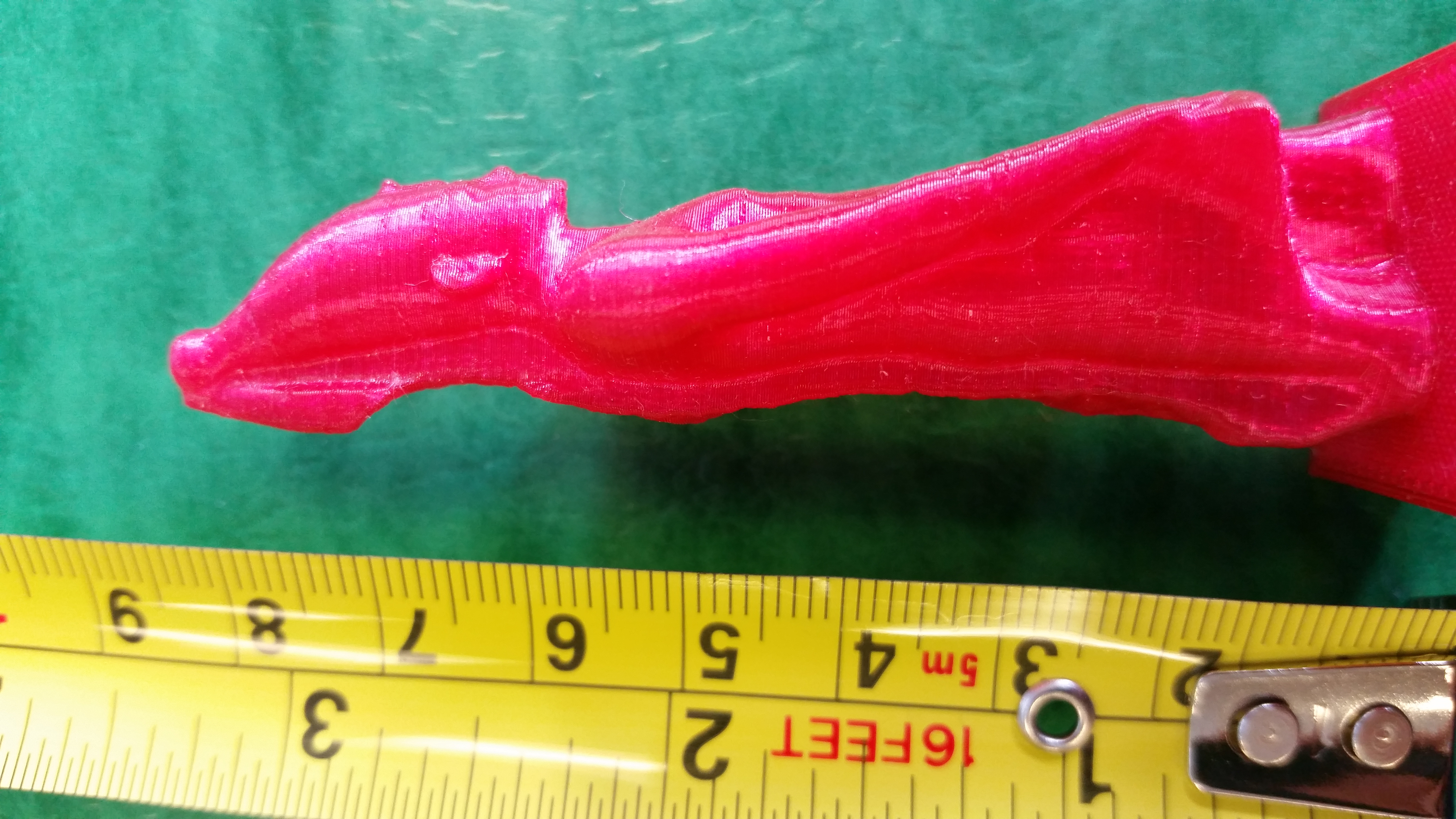

I happen to have a couple of little guys around that same size - in this case about 3.25 inches. Printed with .35mm nozzle and .16mm layer height (I think - might be .2mm or .24, I'm don't recall for sure). esun petg in translucent red.
The models is a repaired version of an 18th dynasty pharaoh in red granite. In this case, S3d auto-generated supports under pharaoh's skirt and between his chest and chin - the latter popped right off without a blemish.

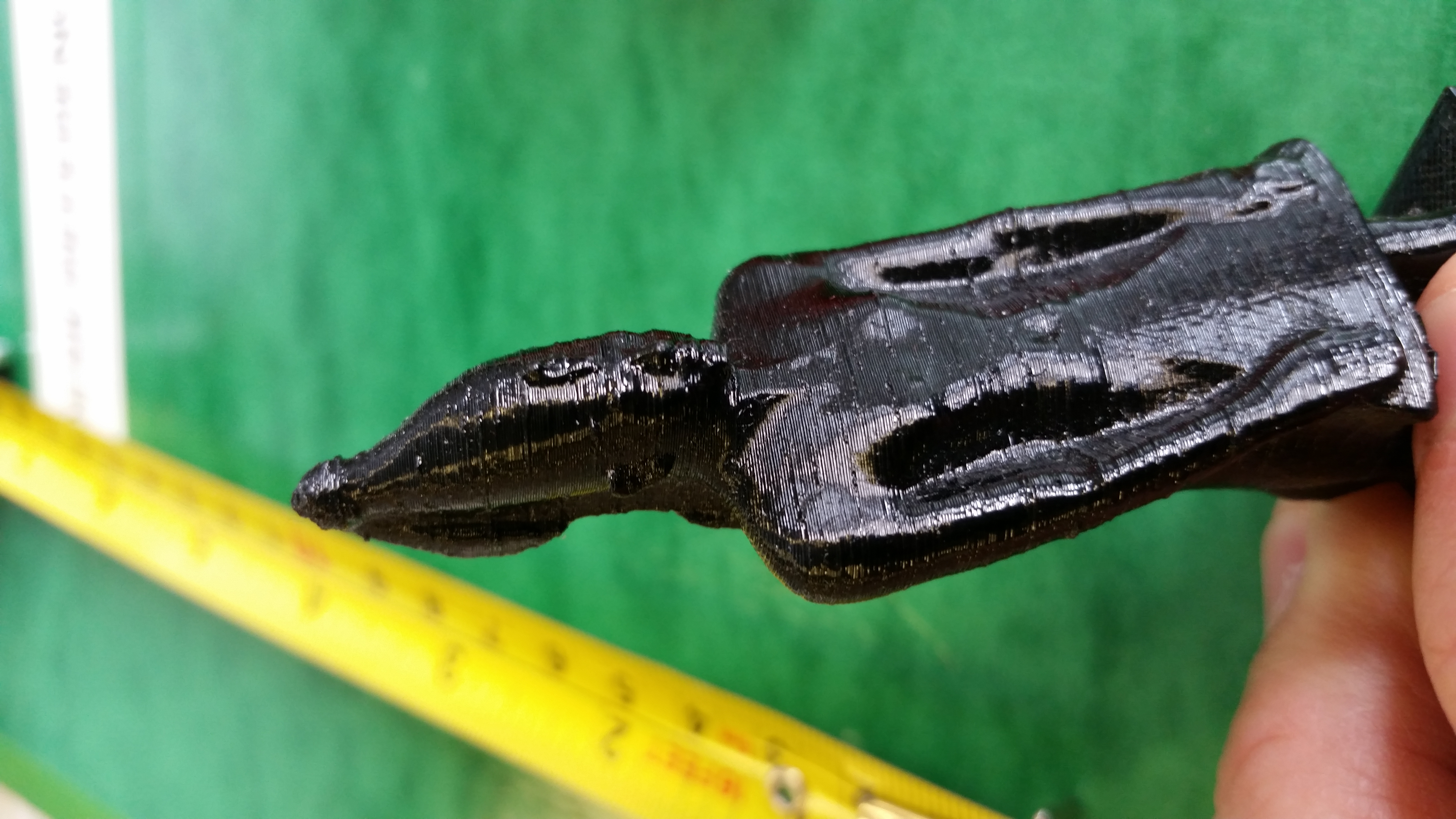

Unfortunately, the details are a little difficult to see due to the material. It might give an idea of what you'll get, however. I have one in opaque black, but unfortunately he suffers from some surface quality issues stemming (I think) from me forgetting to update the filament diameter after changing colors:
He cold be worse, though.
