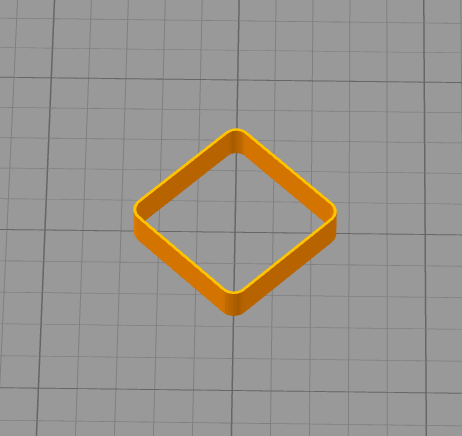

Could not get the outline of the cube to print as described here.
This is the design from https://softsolder.com/2014/04/18/revis ... on-object/ looks like this in S3D
Design
then slices to this
Sliced
Screen Shot 2016-08-10 at 1.46.43 PM.png (24.7 KiB) Viewed 12739 times
I am at 0.20 height and 0.40 for width, which matches the dimensions in OpenSCAD. Curious what I might be doing wrong here.
