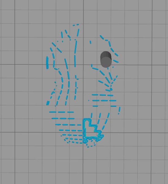

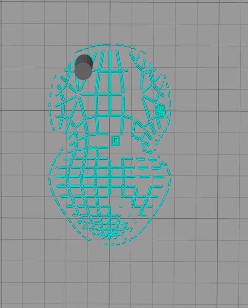

That skull pencil holder model is unprintable as it is. The first layer only has a tiny footprint in one spot - it's actually floating above the bed.
Layer 1
Layer 2
Layer 3
See how there is more on the second and third layers than on the first one?
Basically that messy squiggle that you keep seeing is what happens when you air print - but you are air printing because of the model, not because the gap is wrong. The only way to print that would be with a raft, because the bottom is not even. (at all).

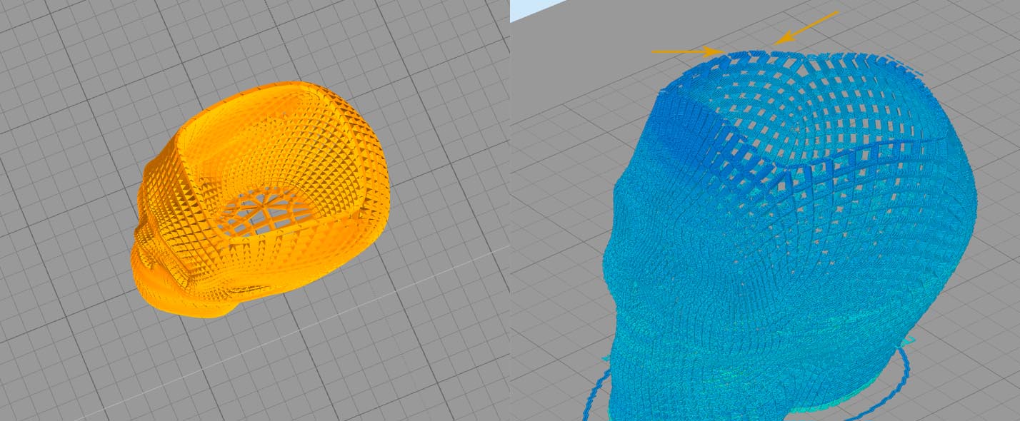

The walls of the skull in the file are too thin for a 0.35 mm nozzle as it is designed. Originally you were using 0.40 mm extruded thread width, and that was yielding walls that were too thin for a solid structure. So i tried to reduce the extruded wall width to 0.36 mm (the lowest you can go and get correct placement with a 0.35 mm nozzle) and did a slice. As shown below where the arrows are, you still do not have a solid structure.
So yeah, anything you print is just going to be a big nest of filament.
The only choices you have if you want to try to print that is to go to a smaller nozzle size, or re-design the file with thicker walls.
