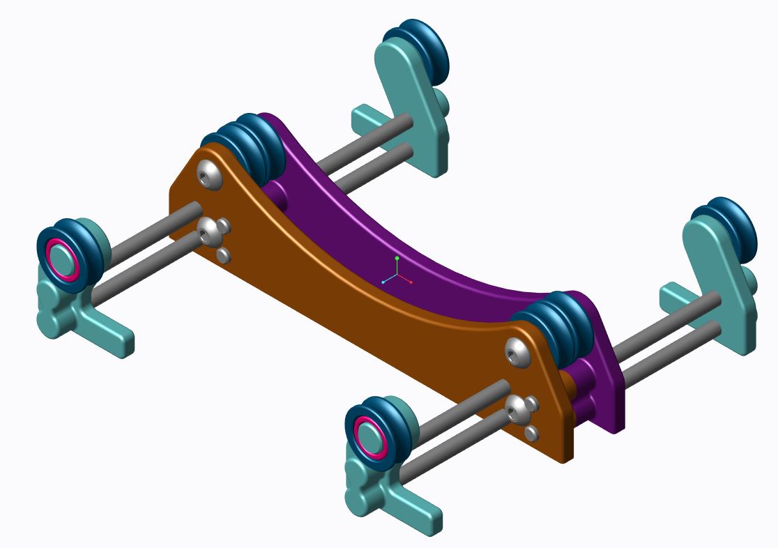

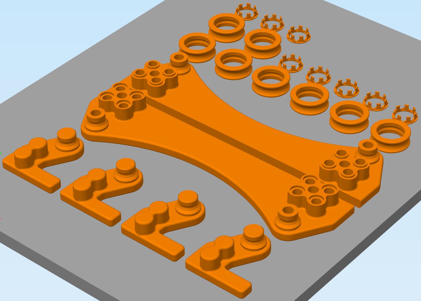

Putting the cart a little before the horse here ... been trying to come up with an idea for a stand for two rolls of filament. Something fairly simple and compact. This came to mind today after I designed the little ball bearing roller for a kayak part I built this morning.
The rollers are designed with races for 3mm balls - and the ball bearing rollers include retainers to control the bearing balls - 7 balls per roller. Dimensional accuracy of the build is critical for the bearing races - but I've been working on getting accurate parts and have that down pretty good these days.
The arms to the outriggers will be 3/16" steel rods. I'll press or glue them in the holes in the outriggers. The build (ABS) is running now and should be done by morning. I'll have to run out and pick up some steel rod so I can assemble it.

Here's the complete assembly. Confession - even though the rollers spin quite freely, the friction between the spool and the rollers is so low they are more likely to slide on the spool than roll.

zemlin wrote:friction between the spool and the rollers is so low
One wrap of silicone tape or snap an O-ring (or two or three) into the groove so the spool rides on the ring(s).
But, hey, sliding supports could get you all the way to the goal...

ednisley wrote:But, hey, sliding supports could get you all the way to the goal...
That's kinda' where I'm at ... yeah, I could make the rollers roll, but it won't make it work any better.
