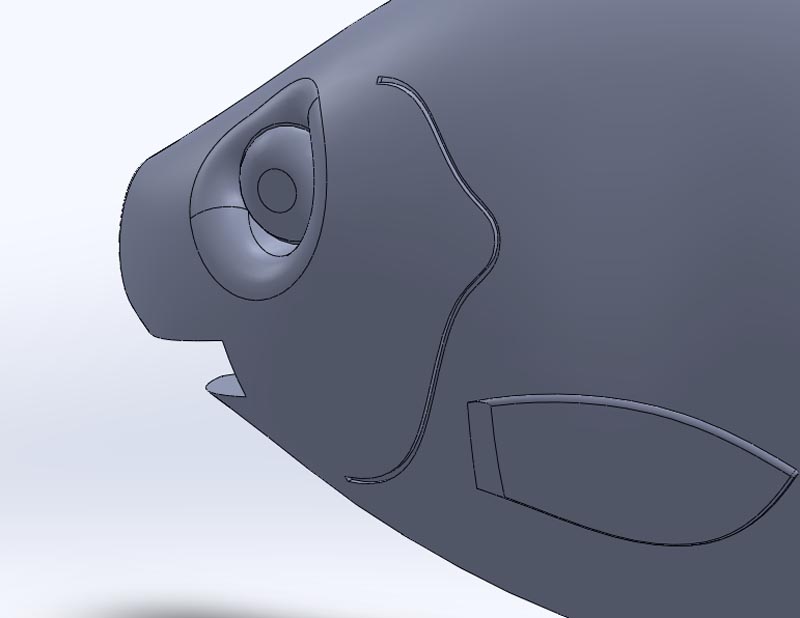

Thanks Jules but that's a sketch offset... I think the term I'm looking for is an "extrude offset from surface". In SW I can draw a sketch on a plane and extrude cut (in this case) into the surface but offset .02 ....
...and the cut then follows the curvature of the surface of the model and is only .02 deep allowing me to add detail.

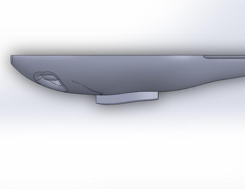

Another example... is to draw a sketch (such as the fin) and have it extrude a certain distance (exaggerated here) but still follow the curve of the surface.
This is what I need to do in Fusion but haven't figured it out yet.

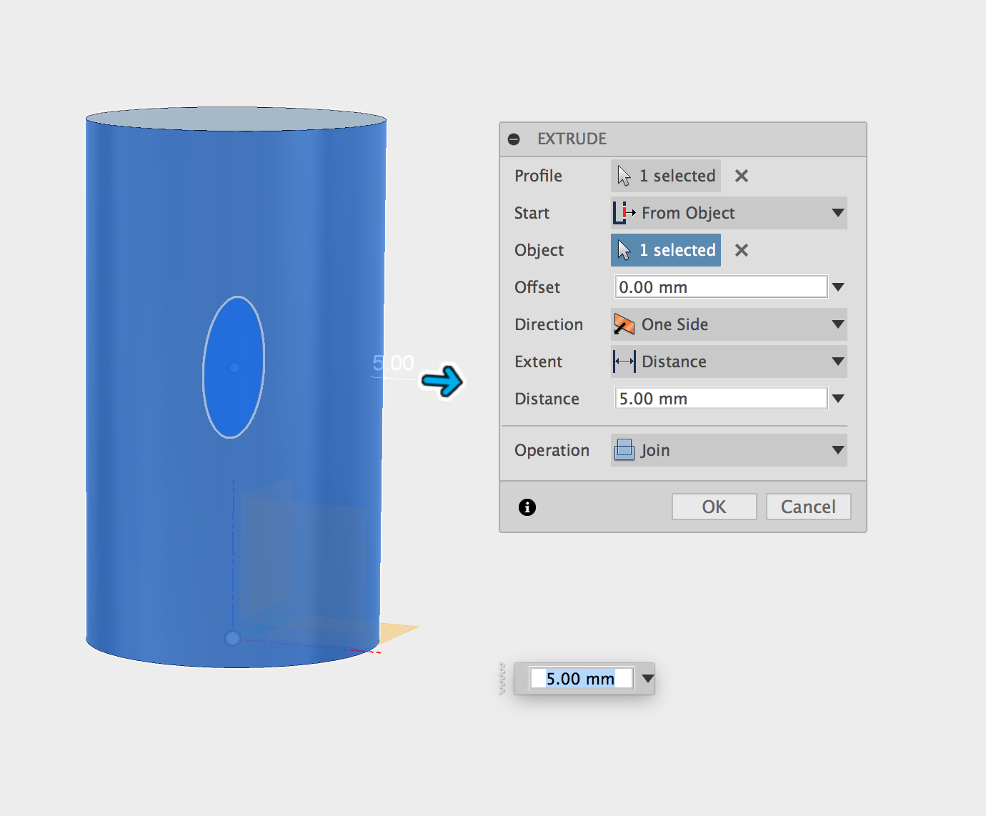

Look what just showed up in today's update:
