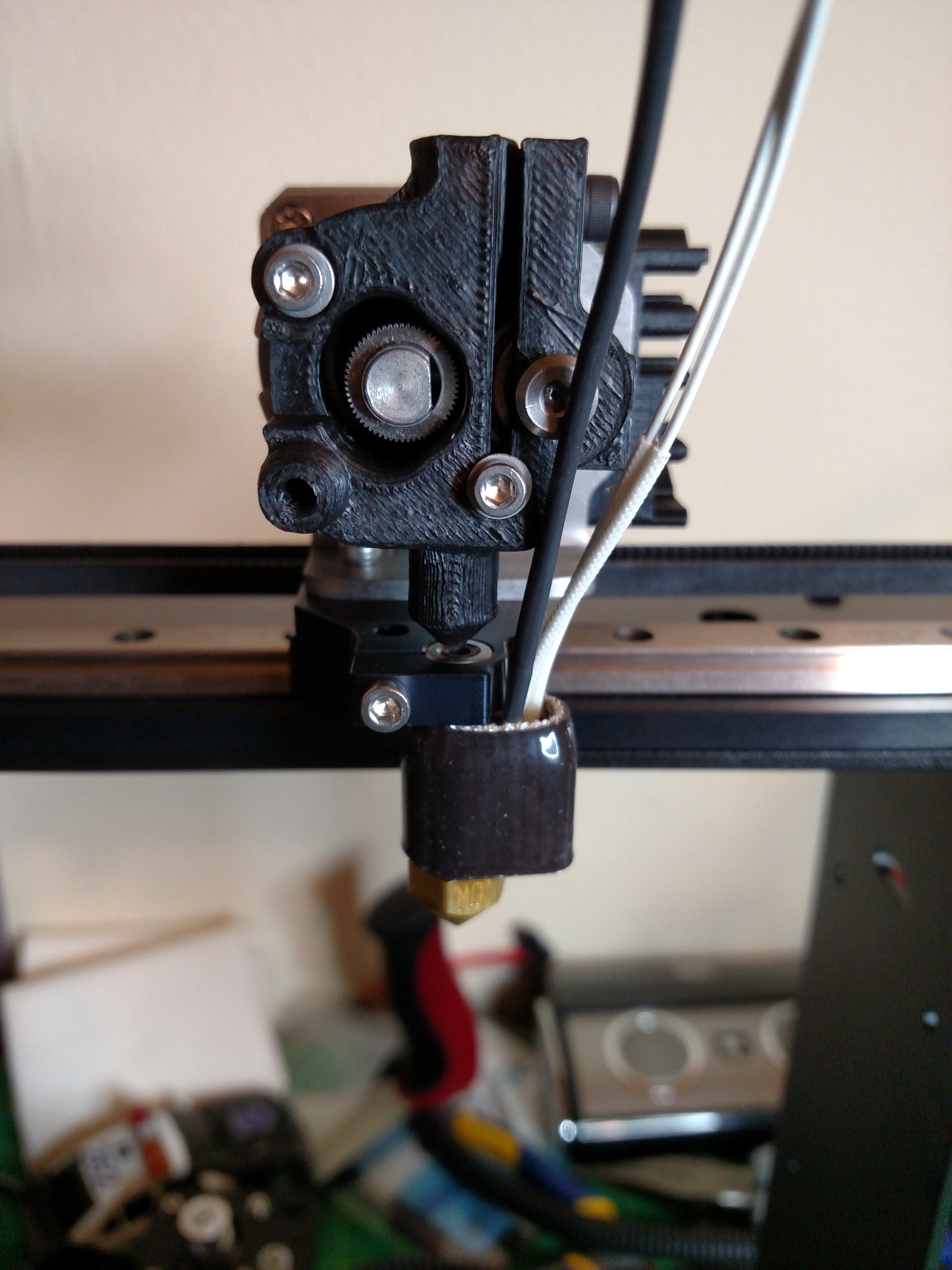

It was a royal pain to get the filament drive to line up with my hot end. It involved modifications that I would not recommend to someone not comfortable with playing with gearbox guts. The issue was the holes in the gearbox absolutely wouldn't let me line up the filament path with the hot end entry. Here's a pic with the filament drive rotated as far clockwise as possible:
Best alignment as recieved

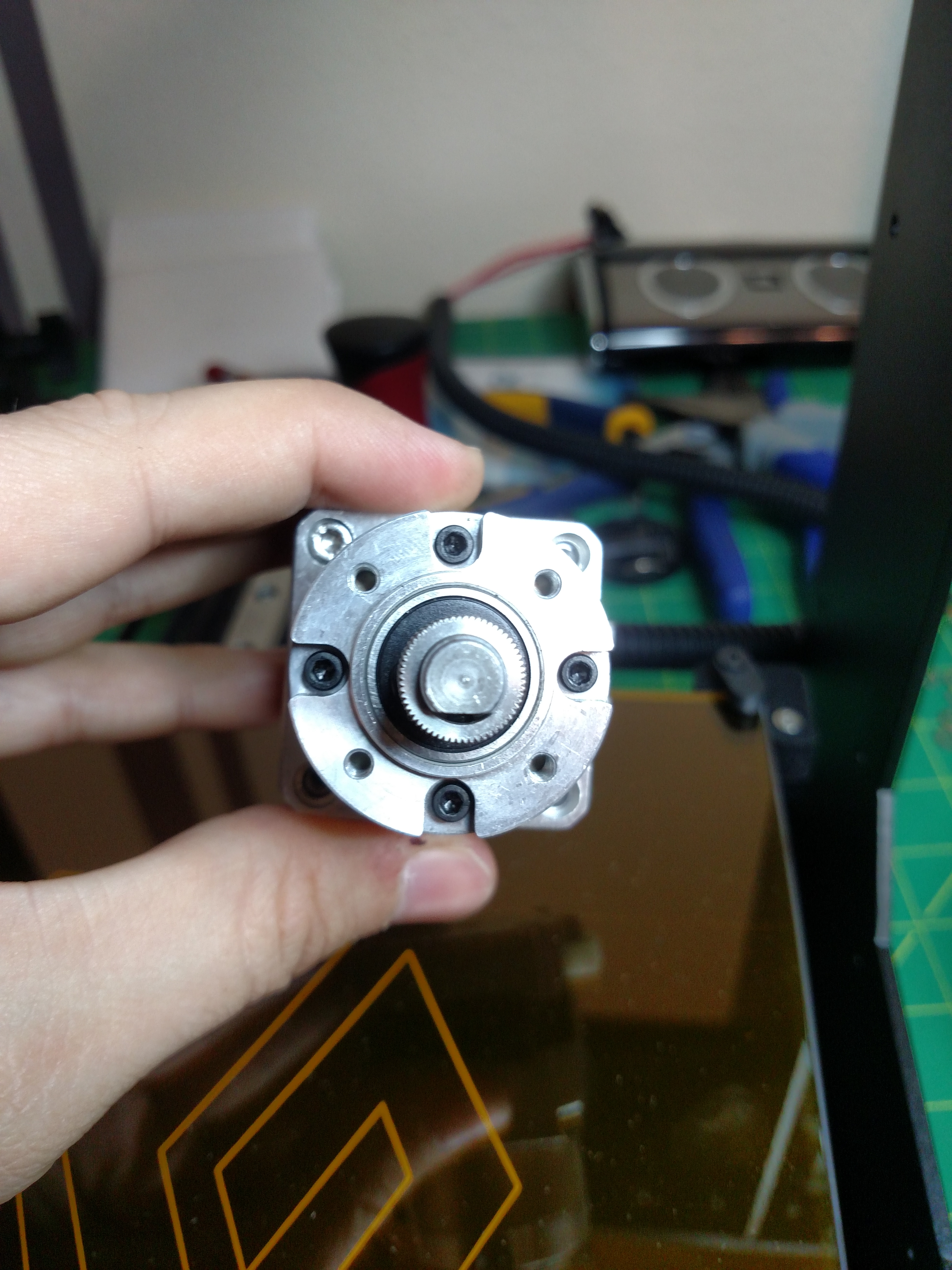

Looking at the front of the gearbox, you can see the hole pattern is distinctly rotated counter-clockwise, despite the faceplate being rotated as far clockwise as possible:
Gearbox face
I think there was a combination of holes being slightly off, and I ended up with the far side of the bell curve. My final solution was to flip the ring gear over, which actually changed things, proving the threaded holes in the ring gear were off a bit. Plus drilling out the holes in the face plate a hair to let me rotate it a little more clockwise. All that means my clockwise limit is now here:
"Fixed" alignment
Which lets me back off a little so nothing's screwed down under strain to keep the alignment. I suspect I just got an unlucky motor for that much modification to be needed. Yes I could've emailed support and gotten a replacement, but I was impatient.
Definitely contact MG Support. I had the exact same issue with the new stepper included in my dual upgrade kit: viewtopic.php?f=13&t=4662#p30084
I sent support@makergear.com a ticket with a link to my post and they shipped a new stepper and RMA label right away.
They must have a bad batch.

That was my first attempt, plus twisting the motor in the metal motor mount. Then I loosened the screws on the back of the gearbox as well, but it still didn't move much. I don't think the screws on the back could help at all, since those holes were drilled and not truly counterbored. The screws wanted to center up on the mild countersink left by the drill. During that process I noticed that the threaded holes in the ring gear must have been off, because one of them was misaligned with the hole in the back plate, and the misalignment followed the ring as I rotated it.
The next step was flipping the ring over (front to back) to see what that did. That got me barely aligned when I torqued everything clockwise, but I wasn't comfortable with having to depend on the screws through the filament drive holding it in place under tension, so finally, I slightly drilled out the holes under the four black screws on the face to get just a little more twist.
