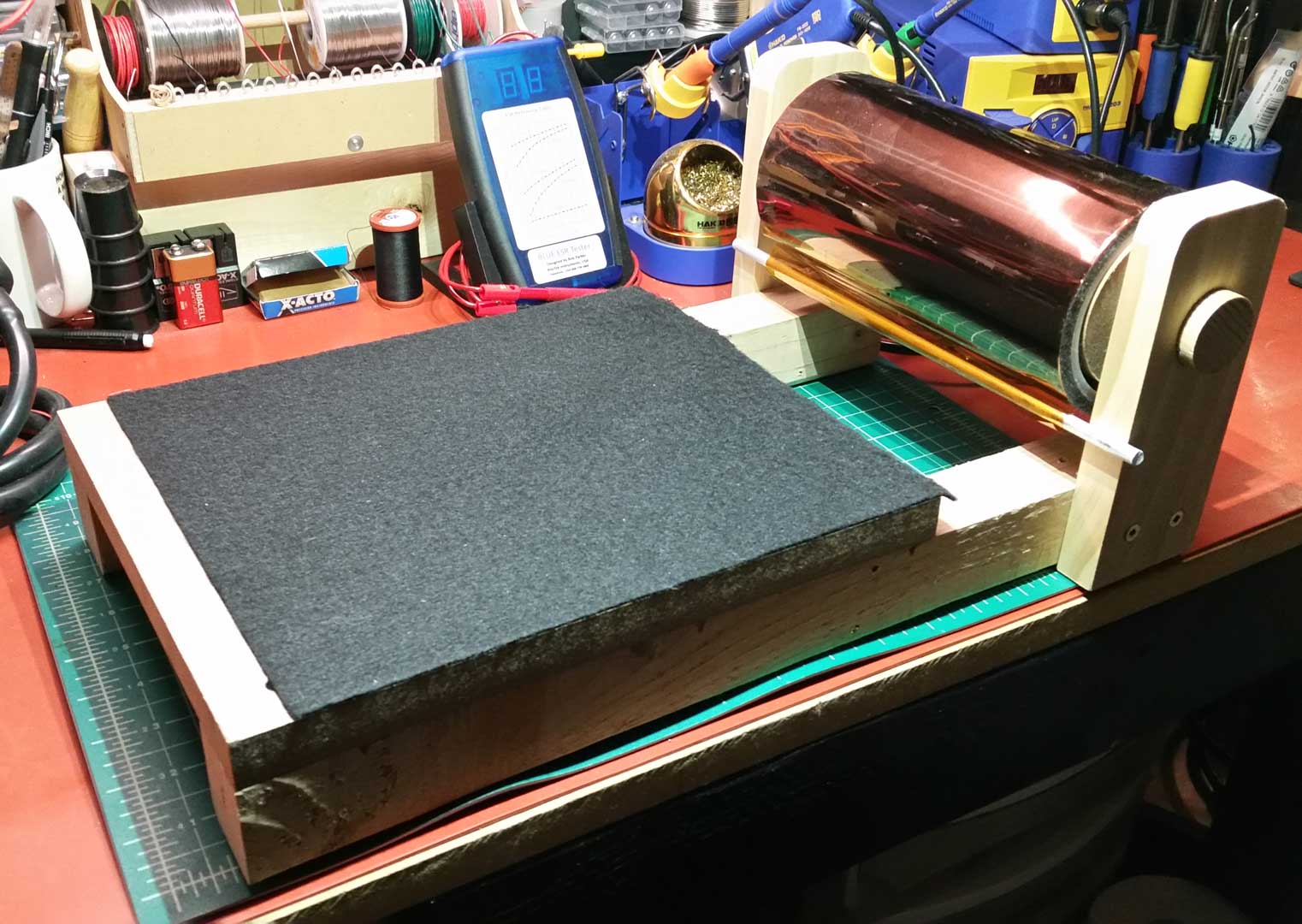

WIth a roll, you can build a jig like I did with just a few pieces of scrap wood: The jig was a game-changer for me. It used to take 30 minutes to do one replacement but now It only takes me just a few minutes: I too got really frustrated the first few times I tried with the smaller tape.
Anyway...just another perspective for you.

I think I need to build a couple Kapton film application jigs like that, Hugs: One for myself at home (I have an M2 dual), and one for work (we have an M3 ID). I had been using a MIC6 plate with PEI, but after a disastrous experiment with some conductive filament that stuck too well to the PEI, I decided to go back to plain old Kapton over glass and learn how to replace the Kapton when needed.
Would you mind describing how you put down the film without bubbles? I can see that you use a piece of dowel rod to stretch out the filament between the roll and the near edge of the jig, but then what do you do to smooth out the film on the glass?

NF6X wrote:Would you mind describing how you put down the film without bubbles? I can see that you use a piece of dowel rod to stretch out the filament between the roll and the near edge of the jig, but then what do you do to smooth out the film on the glass?
- The glass gets a spritz of distilled water with a few drops of dish soap.
- After pulling the tape to the end of the jig, the first "trick" is to let it rest for a few minutes. An 8" roll takes a bit of force to unwind and in the process gets a little stretched.
- The grey stuff is a sheet of self-stick felt which helps the glass slide. Notice it's about an inch up from the edge were the kapton is hanging off so I don't stick the Kapton on felt and get fuzzies.
- The second trick is to slide the glass down into the tape. The edge keeps it nice and straight and the angle keeps just the very edge of the tape in contact with just the very edge of the glass.
- Then I use a piece of a shower squeegee and slowly work up from the bottom smoothing as I go. Again, that angle is your friend, keeping the tape from touching the glass until you start squeegeeing.

Thank you very much for explaining how you apply the film, Hugs. I knew there had to be some technique involved.
