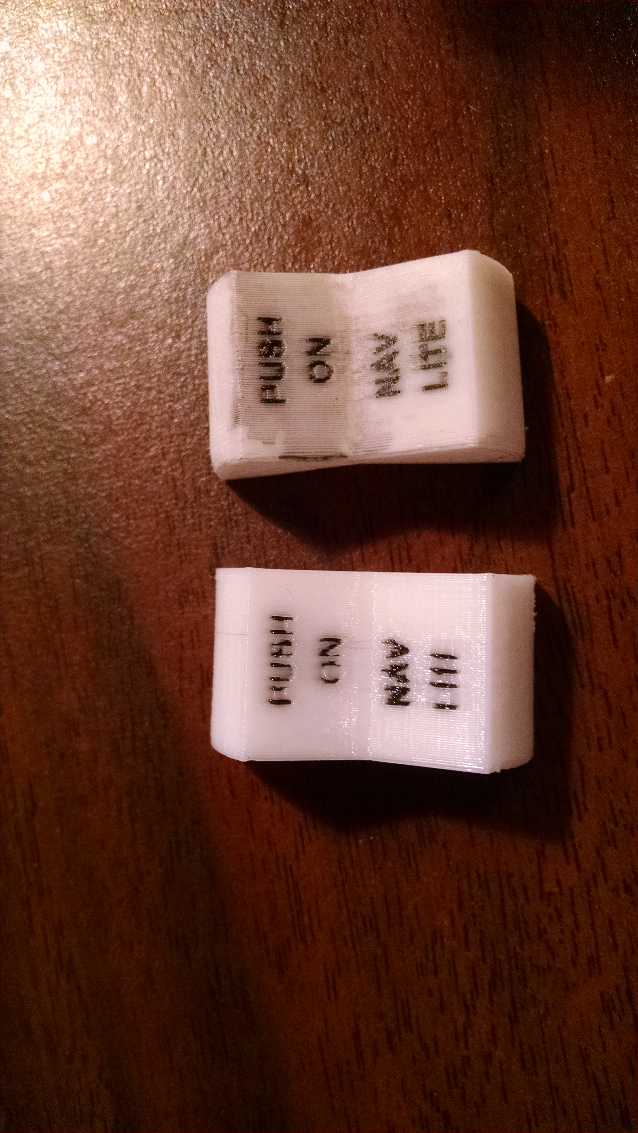

I have been trying this very thing for a while. I have some switch covers I need to replace, and I would like to get the lettering to be as precise as possible. I really thought printing the cover in white PLA with the lettering in black PLA might do the trick, but alas, it still leaves much to be desired. I used black nail polish to fill in the lettering the black filament missed on the right cover, so you can tell the second extrusion does not help as much as you might hope. (The nail polish also leaves residual in the crevices, leaving what looks like a film on the switch cover.)

Post by Jules » Tue Mar 14, 2017 7:07 pm
The shape of those makes it impossible to do what I would have suggested, which would be to pause the print and print the text raised on the design in a different color. If it were a horizontal top, you could maybe get away with it. But that canted angle makes it impossible.
That would be a tough one.
