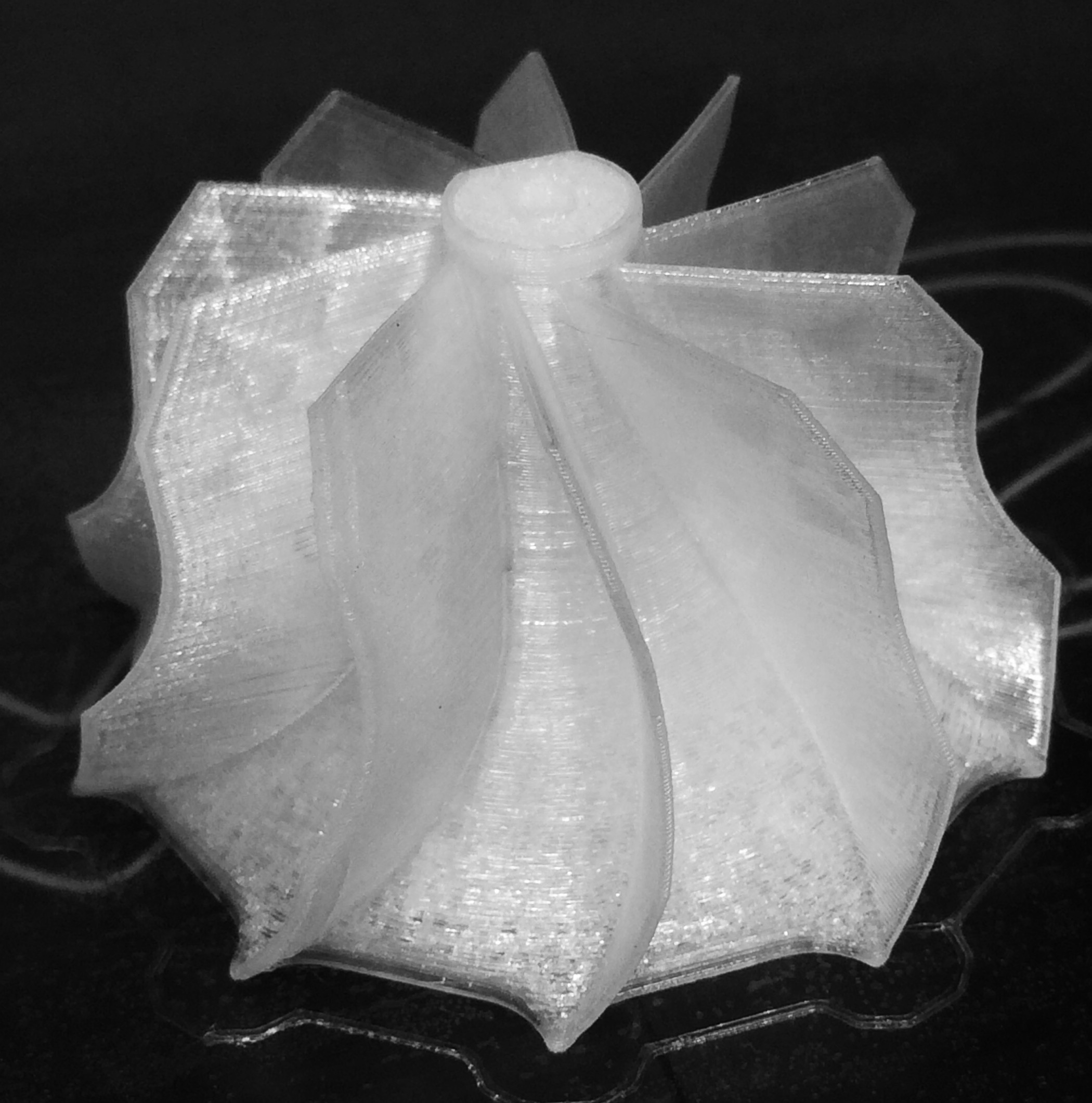

I am impressed with Taulman's Alloy 910. Bed adhesion is excellent; PEI with PVA glue stick, 45°C bed temp. Prints are clean, minimal stringing, virtually no start/stop discontinuities. Printing at 260°C extruder temp with a V3; be advised I have checked my extruder temp with a thermocouple inserted in the heater block temp well and know it runs 8°F cooler than the control set point. I have attached a photo of a turbine wheel printed with these setting. Note that I have not optimized the bridging properties. I am starting with the settings given by jules for PETG.
Taulman_910_Fine.fff
FFF for Taulman Alloy 910, 0.2mm layer height
(9.77 KiB) Downloaded 1112 times
Taulman Alloy 910 at 0.2mm layer height
