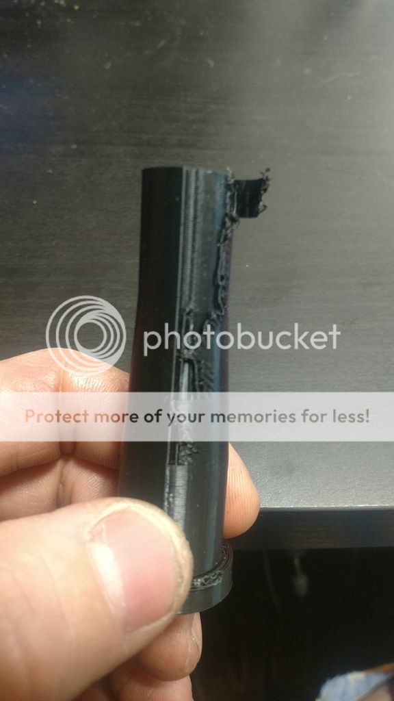

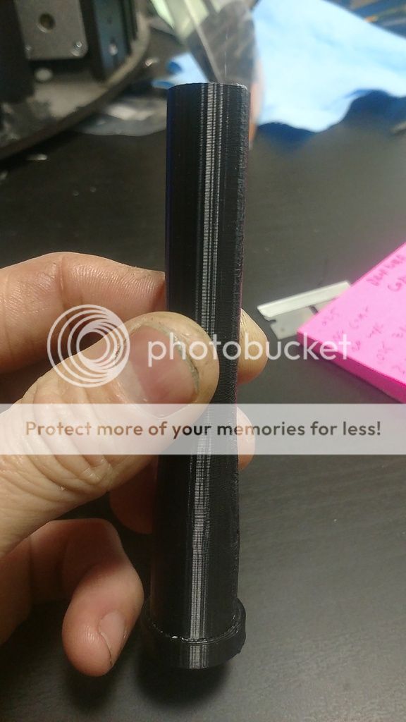

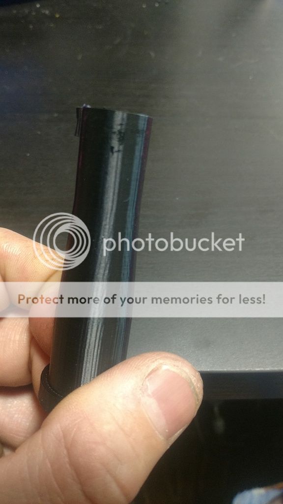

I have attached some pics and the two stl files.
I am using a .035 nozzle with a .4 width at .2 layer height. I also tried .25 layer to get a faster print with a .42 with and a .45 layer. I skinnier of the two models (the one with the cut out in it) Is two walls thick and with the fill gaps I can get S3D to extrude in between those two walls.
The other model I have tried same settings as above with 2 and 3 walls. 60mms to 30mms. All in ABS, I can (tube insert) model to print better if I use PLA.
These were printed .25 layer .042 width, 3 walls, -.5 retract, 2mm wipe and I believe no coast.
This was the best I could do. Same layers, and wall, no coast, 1mm wipe, 30mms, no retraction, 0 on restart, and I think I I may have printed two parts at one time. Can be sure, I have printed so many and my notes got a little mixed up. IC3D ABS and maker gear ABS 245C.
The last two photos the part is not that bad but off of the rostock I only have a very small vertical line that is indented not raised.
Other relevant settings, extrution multipler is 1. Only retract when crossing open spaces. Wipe on retract. Print outside layers first, this helped fix the first picture. Retraction speed 120mms
This is the best I got the other part to print.
I printed two and then four at a time hoping to cool the part a little.
.25 layer
.42 width
1mm retract
.25 vertical lift
120mms retract speed
no wipe, no coast
30mms print speed
retract over open spaces
force retract between layers
outside to in

Re: How do I print a circular part?
ED,
"Eliminate coast & extra-on-start, get the zits lined up, adjust the retraction until it's pretty good, then fine-tune with coast & extra."
sorry not sure how to quote your quote from the post,
I got the zits lined up, I will try the coast and extra as you stated.
"Although I don't use S3D and don't know its keywords, it has a setting to control the position of the layer steps. Pick "aligned" to put all the zits together or "nearest" to put them at the closest vertex.
However, the model geometry affects the zit position, so experimentation will be your friend. To avoid wasting filament, preview the G-Code at http://gcode.ws/ to make sure everything lines up the way you expect."
Yes S3D will allow you to use random start points, which gives you the zits.
Optimize start points for faster printing or
Choose start points closest to a XY location.
I do the last one.
Also S3D will show you where your retracts and other positions will be, and will even show your coast and wipe lack of extrusion. Shows you the positive bump you will get as well.
If I get the model viewer to get rid of all of the flaws the part still has them. If only it was that easy that would be perfect. Thank you for taking the time. I have some parts that need to go out so I will be using the rostock for them:(
The ID prints everything else I have thrown at it just perfect! But these are the parts I really need it to print and I need them in ABS.
Gonna do some more testing.
I do the last one.
rs50pilot wrote:If I get the model viewer to get rid of all of the flaws the part still has them
Which means the assumptions made by the previewer don't match the physical reality, so your job is to reduce the discrepancy.
I infer you have not actually calibrated the Extrusion Multiplier, which is the absolutely key variable in the whole collection of settings. Search the forums (with Google, et al, as the forum search is weak) for my previous impassioned rants.extrution multipler is 1
The slicer assumes the extruder squirts out exactly the amount of plastic required to fill the available space. The plastic volume depends on both the actual, measured filament diameter and the Extrusion Multiplier.
Reset all the retract / coast / whatever numbers to their original default values, measure the filament diameter, calibrate the Extrusion Multiplier, then see what happens.
The detailed calibration process should be in the startup guide, but the general idea is to print a single-wall open box with an ideal thread width, measure the actual width, multiply the EM by the ideal / actual ratio, and iterate a few times.
For example, if the slicer assumes the thread width will be 0.40 mm, but you measure 0.45, then the correct Extrusion Multiplier will be (close to) 1.0 x 0.40 / 0.45 = 0.89. Adjust the EM, print another thinwall box, measure it, and it should be just about spot on. Tweak as needed, iterate once or twice, then move on to re-tweak all the tedious retraction / coast / whatever settings.
Some examples of close-but-not-quite-right EM values:
https://softsolder.com/2013/09/17/extru ... s-thereof/
IIRC, S3D uses a single Extrusion Multiplier value for both extruders. If I remember wrong, which I hope is the case, then you can calibrate both extruders and get ideal results. If they share a common EM, then you must calibrate both and pick a compromise EM to produce equally wrong results.
Measure thrice, calibrate twice, print once ...
