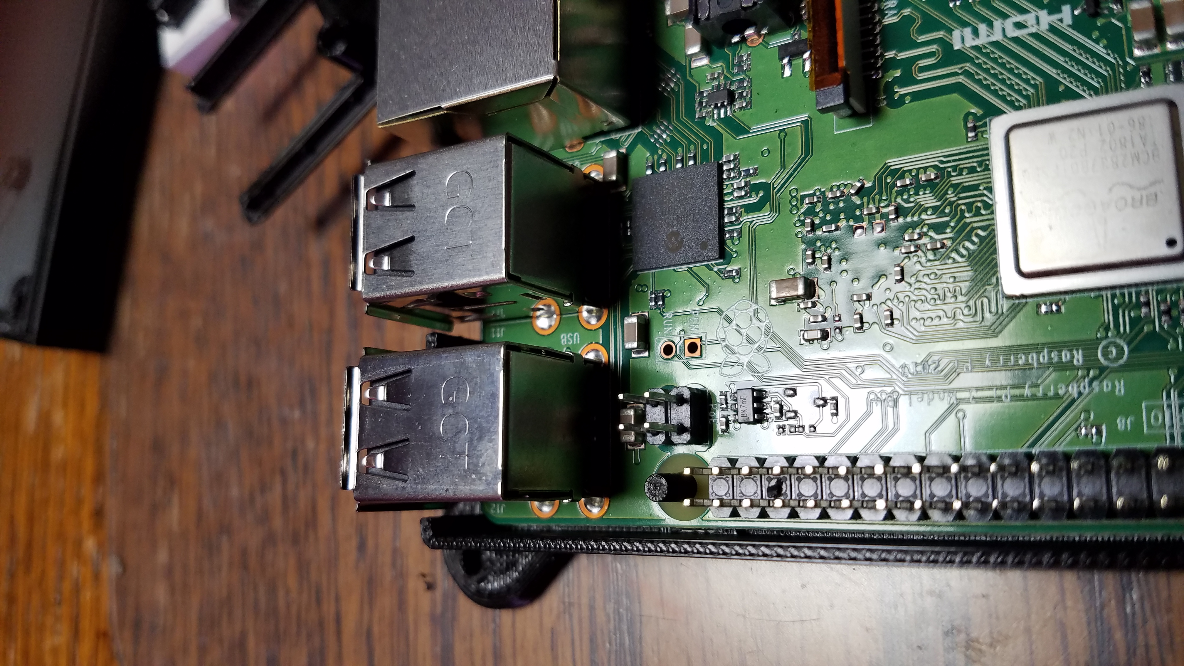

https://www.thingiverse.com/thing:2896278 However it won't fit the B+ as there is an additional 4 pins that must not exist on the older model .
