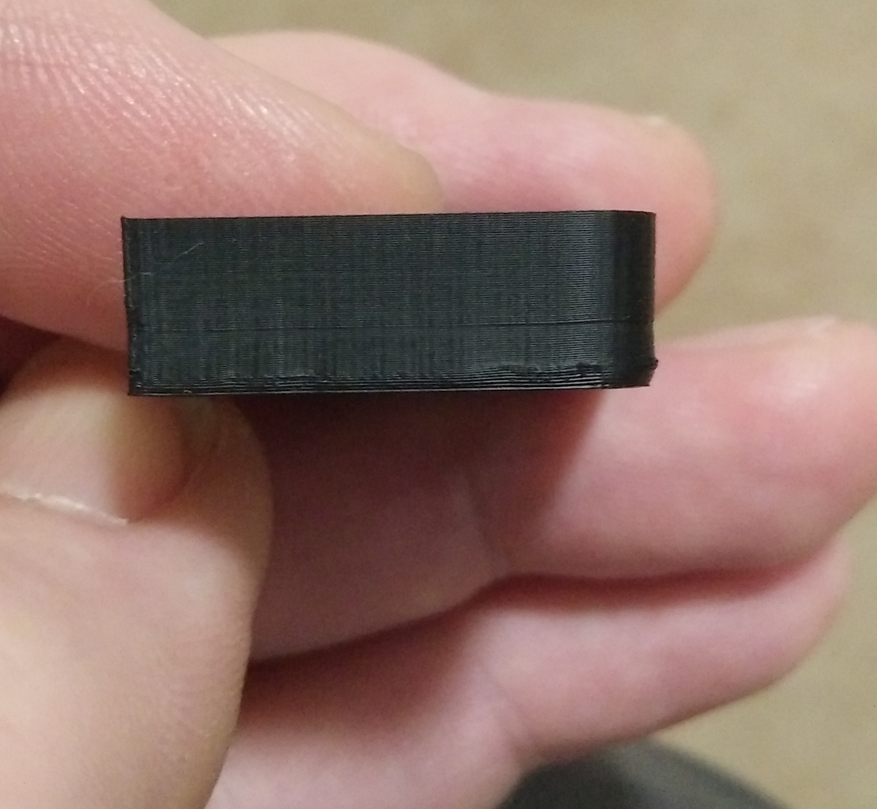

The other issue, or probably the same - see attached. The surfaces on the side of the model are being sucked in around the screw holes, or so it seems. It's a lot more noticeable on the S3D print, as well as the less then vertical walls. Could it be an infill setting? I'm using lines at 30%. 5 bottom layers and 6 top layers. With Cura it seems a lot less severe. My other printer (prusa i3 mk3) and sliced in Slic3r, same filament and the surface is close to perfect. It's a strange one for me.... can't seem to work it out.

Thanks again airscapes. The STL I can't share as it belongs to a company. The filament in these pics is eSun ABS+ and I have also tried Zortrax ABS with same results. The Zortrax ABS prints at a much higher temp of 270, the eSun at 240.
I printed the whole part last night using the Cura sliced gcode and it turned out very similar to the S3D print, possibly slightly better. So, slicing off a portion of the model to use as a test is not a fair comparison in this case.

Decided to reset my M3 back to factory defaults, put in my spare hot end and clean nozzle. I also deleted my eSun ABS profile and started again. Printing at 0.15 layer height looks quite good. Will try 0.1mm tomorrow. Feeling positive about this one, this time.
