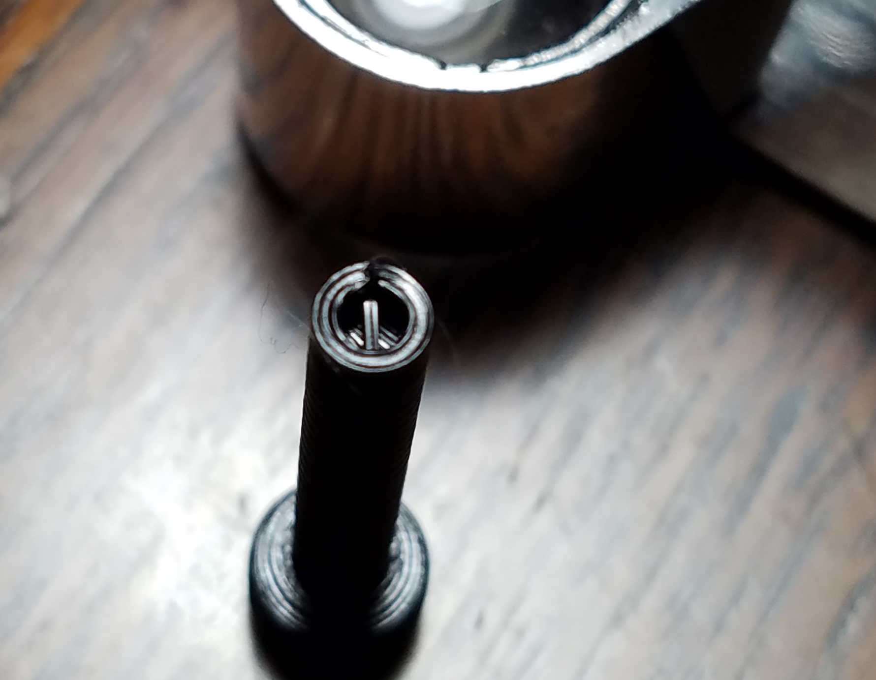

Post by jfstanley » Sat Mar 02, 2019 11:35 pm
it seems to work pretty well for what I'm doing. the .25 nozzle isn't clogging either. it's great filament

Post by Pekish79 » Mon Mar 04, 2019 7:30 am
problem is that people just think as the universe end with themselves.
the fact that your specific use is ok with .25 doesn't make it a reasonable nozzle
if you printed a lot and not only that thing you will know that nozzle clog that the smaller the easier to clog and mass producing something like that will create problem as most people will complain if they get clogged to easily or after few print instead of .25 they are already .3
but if you didn't get the concept before i doubt this will clear things up
.25 have very very little use and this is why is rarely made wouldn't be better try to calibrate your object to a .35

Post by jfstanley » Mon Mar 04, 2019 4:06 pm
listen pal, I was simply showing an example of how a .25 SS nozzle is a viable and useful piece of equipment for printing with metal filament, and I've done many of these without clogs. If you feel the need to be arrogant and insulting then feel free to traipse off to another thread and give your valuable advice elsewhere.

Post by airscapes » Tue Mar 05, 2019 1:48 am
In the defense of the .25 nozzle.. let me see you print a 28mm D&D miniature with the 3.5.. The .25 does not clog if properly maintained with cleaning filament. It is my favorite nozzle when I need to print something small. I even use an Extrusion width of .25 at time! It prints Taulman alloy 910 like butter!
If you print something big, you use the .5 .. proper tool for the job, and if you want detail .25 is the king!
