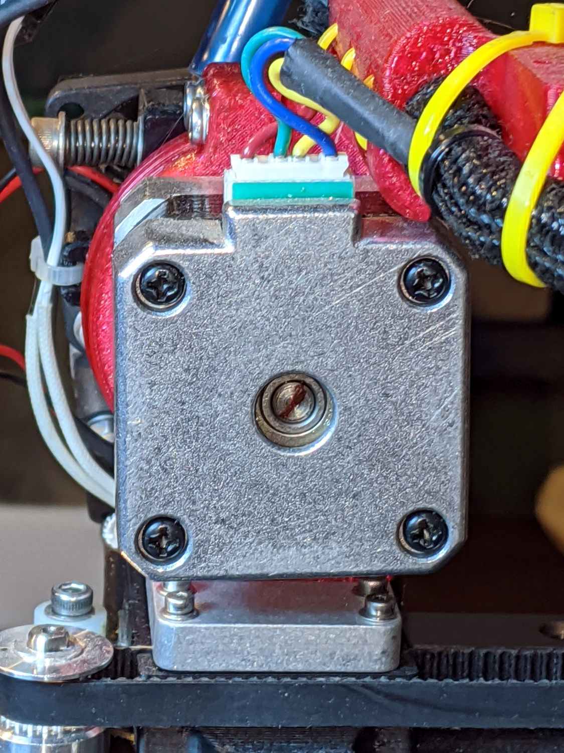

The only rotating parts you can see are the gear shaft (inside the filament drive gear):
And the motor shaft (toward the gantry):
The gearbox has a 5:1 reduction, so the motor shaft turns much faster than the drive gear shaft. If the motor continues to turn while the drive gear doesn't, then the pinion gear inside the gearbox is defunct.
I drew those lines on the shafts & gear long ago and they're a great debugging tool for seeing what's turning in relation to what's not. Here's an earlier version of the drive gear in free air:
The drive gear & the idler bearing aim the filament differently than the straight-line path you feel by hand, so the end of the filament may be hitting the side of the hole rather than going into it. That can also be due to the plastic block wearing away, but it's hard to tell from outside.the filament stops just as it clears the bearing/extruder gear drive area and starts back into the 3D printed block
