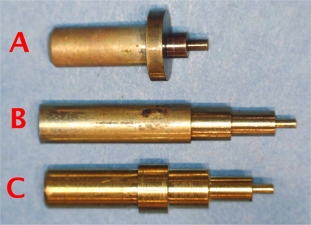

I ended up experimenting with three different tips. The tips McMaster Carr sells to go with their soldering iron are very short, which provides a low thermal resistance to the insert, but it also doesn't allow installing inserts down inside a small cavity, or a very good view of what you are doing. I got a set of inserts from Amazon that are designed for a Hakko temperature controlled iron, but are also supposed to be compatible with the Weller from McMaster. They are longer, which is nice, but they don't have a shoulder and they can slip up inside the Weller, which messes up the depth setting. I ended up making a hybrid that has a shoulder like the McMaster, but the longer reach of the Amazon tips.
Here's a photo of the three tips. "A" is the McMaster, "B" is from the Amazon set, and "C" is my home brew hybrid.
