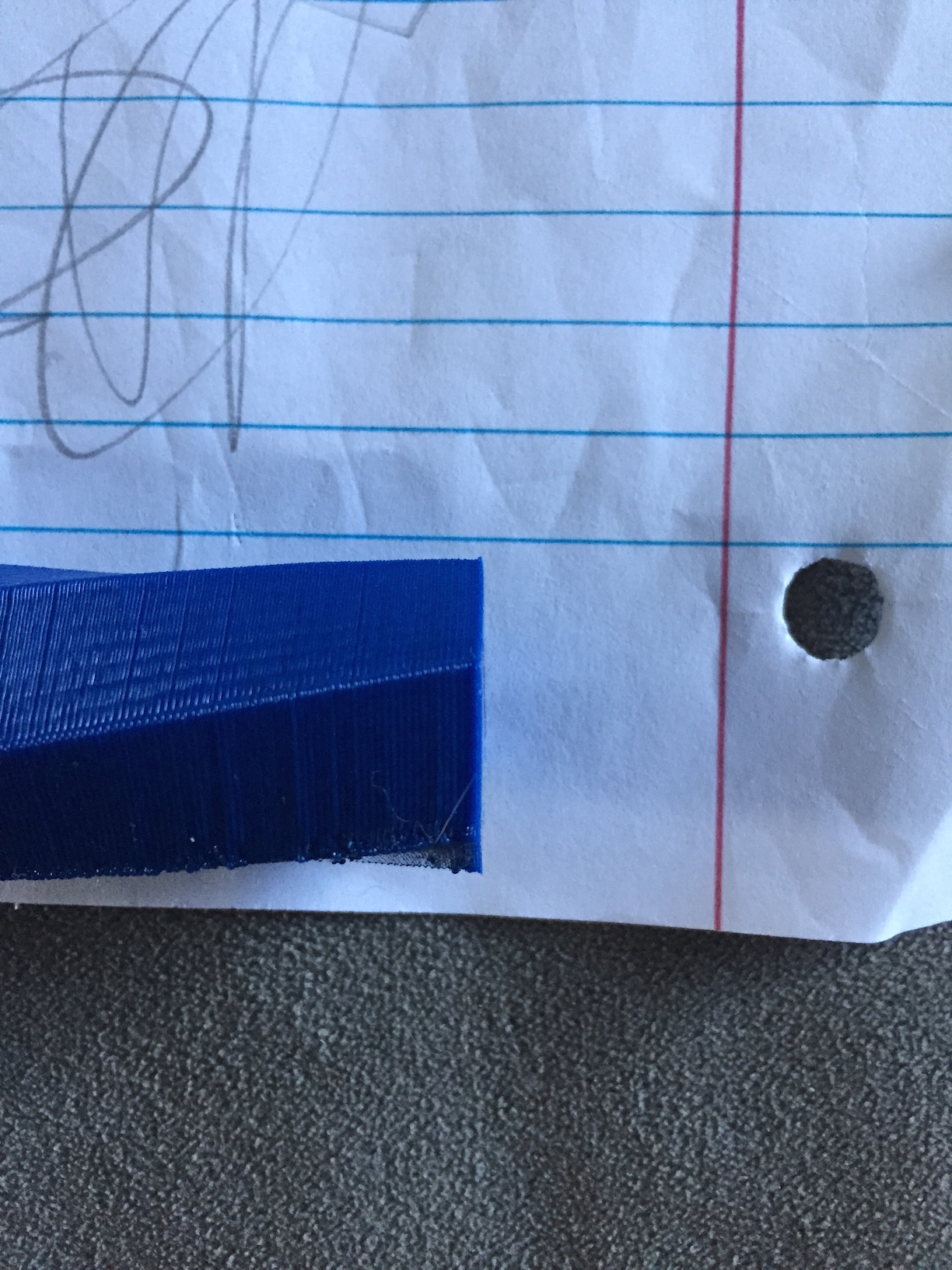

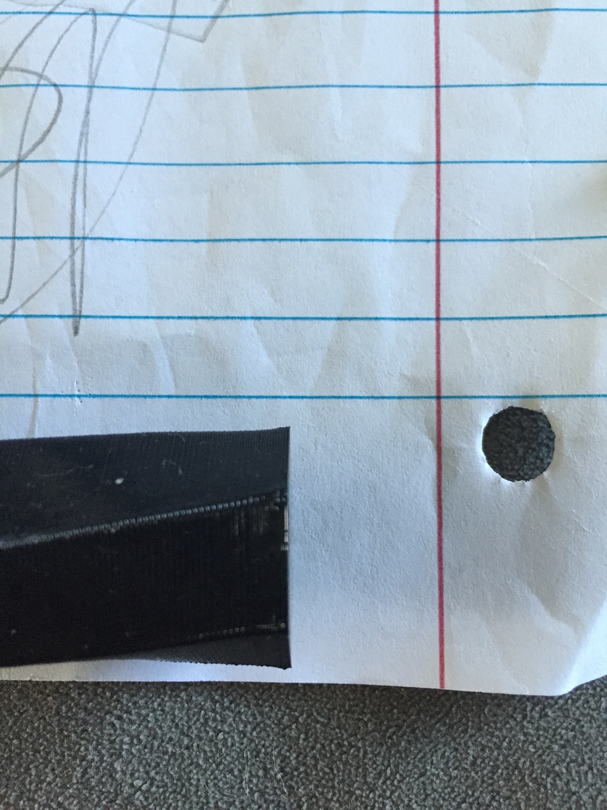

Print came out good but after closer inspection I noticed it didn't come out as good as the sample print MakerGear included in the box. I've attached pics-- blue is the sample print from MakerGear, black is my print.

Here are the issues I see...

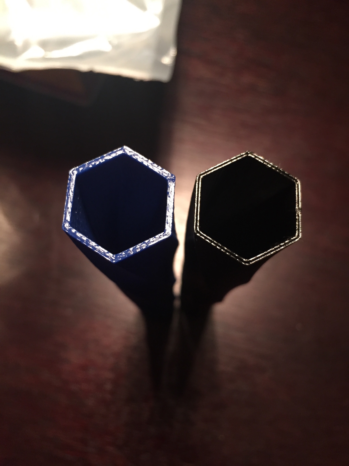

1. There's a noticeable "gap" between the inside and outside walls. I say "gap" because I can push my fingernail in there and the PLA spreads apart.
2. Due to 1, the whole piece is more flexible than the blue one. Blue one is stronger/more sturdy overall.
3. There's a line that goes up the middle of one flat side. This is through the whole print from the bottom to the top. Thing is, the line starts at the bottom in a corner where two flat sides meet. Over the next 3cm on the Z axis, it zigzags until it gets directly into the middle of the flat side and stays in the middle for the remaining 15cm (guessing) height of the piece. The pic I attached shows how it starts at a bottom corner and moves to the middle.
In Simplify 3D, I changed the process settings from medium quality to high quality (only thing I see that the quality setting changed was infill from 20% to 30%) and reprinted. Didn't make a difference-- piece came out the exact same. During the print I was thinking-- would changing process settings in S3D effect print quality when printing an already made .G file off an SD card or do those settings only apply when you use S3D to slice and/or print directly to the printer?
What can I do so tallthin.g prints exactly like the sample print from MakerGear? I'm waiting to print anything else until I figure this out. Don't want to waste filament if this is going to possibly effect other prints.

Re: First print-- issues with tallthin.g from the SD card...
Post by jsc » Sat Sep 12, 2015 4:09 am
Check the "M2 tips" thread in the Tips forum for some beginner links. Also there is a recent thread trying to bring together some useful current discussions for beginners. Some quick responses:
S3D settings only apply to gcode files that it generates. Once you get to gcode, all the settings are baked in.
You can improve your print by carrying out an extruder calibration (link to instructions in the tips thread).
The seam you are seeing is where it begins each layer. It looks like it starts on a flat surface, but the sides are not completely flat. You can control where that seam goes (and reduce it somewhat) by tweaking your settings.
But, first things first. Run an extrusion calibration test, and take the opportunity to dial in your z offset.

There are some settings that you need to adjust to fix a couple of the issues on your print:
1. Adjust the width of the extruded thread to fix the gap problem between the walls. It looks to me like it had an extruded width that is too high (like 0.5mm), and the total width of the wall is only 1.4mm. So S3D dropped the middle thread. (If it can't fit it in, it drops it.) Change your extruded width to 0.4mm, and the layer height to 0.2mm. You'll probably get a solid wall. (And if you don't - stop the print. You don't have to print the whole thing if something is amiss.)
2. You need to adjust your retraction settings to minimize that line of blobs that appear at the start of the layers. For PLA, that is all that is generally needed. The ones that come on the SD card are probably just a generic setting - they will give you a print, but it's not going to be the best quality for the filament that you are printing now.
3. Learning to adjust the settings in S3D to give you the best result for whatever filament you are printing (and it changes for each spool) is the main thing we do in the beginning. The best way to learn it is to jump in and start printing - but use something small at first, like the calibration squares. The very first thing you should do is calibrate the extrusion width (and height) for that roll of filament, and you do that for every new spool. It will get you familiar with how the machine operates and not take a tremendous amount of time. Save those settings as a profile in S3D. Then use that whenever you print from that spool.

No, jin's advice was not just an off-the-cuff suggestion - the first thing you need to do is the extrusion calibration. Without doing that, you haven't got a prayer of matching the sample print.
Every spool of filament is different. They have non-uniform diameters that have to be adjusted using the correct filament diameter and extrusion multipliers. No telling how long ago that SD card file was created, or what kind of nozzle was in use when it was created. I think it's over-extruding based on the results you are seeing. If you don't calibrate, you'll never get rid of the blobs - 'cause those are definitely too much plastic coming out. The first few layers are crammed together - again over-extruding. You need to calibrate.
Also, for PLA, your temps are too high. (Yes those might be the recommended starting settings, but it's not needed and you are always better off extruding on the low side for filaments.)
For PLA if you have a V4 nozzle - try an extruder temp in the 205 - 210 range, and the bed temp in the 40 -50 range. The filament might also be flowing too much because of the temps and getting smashed at the bottom.
