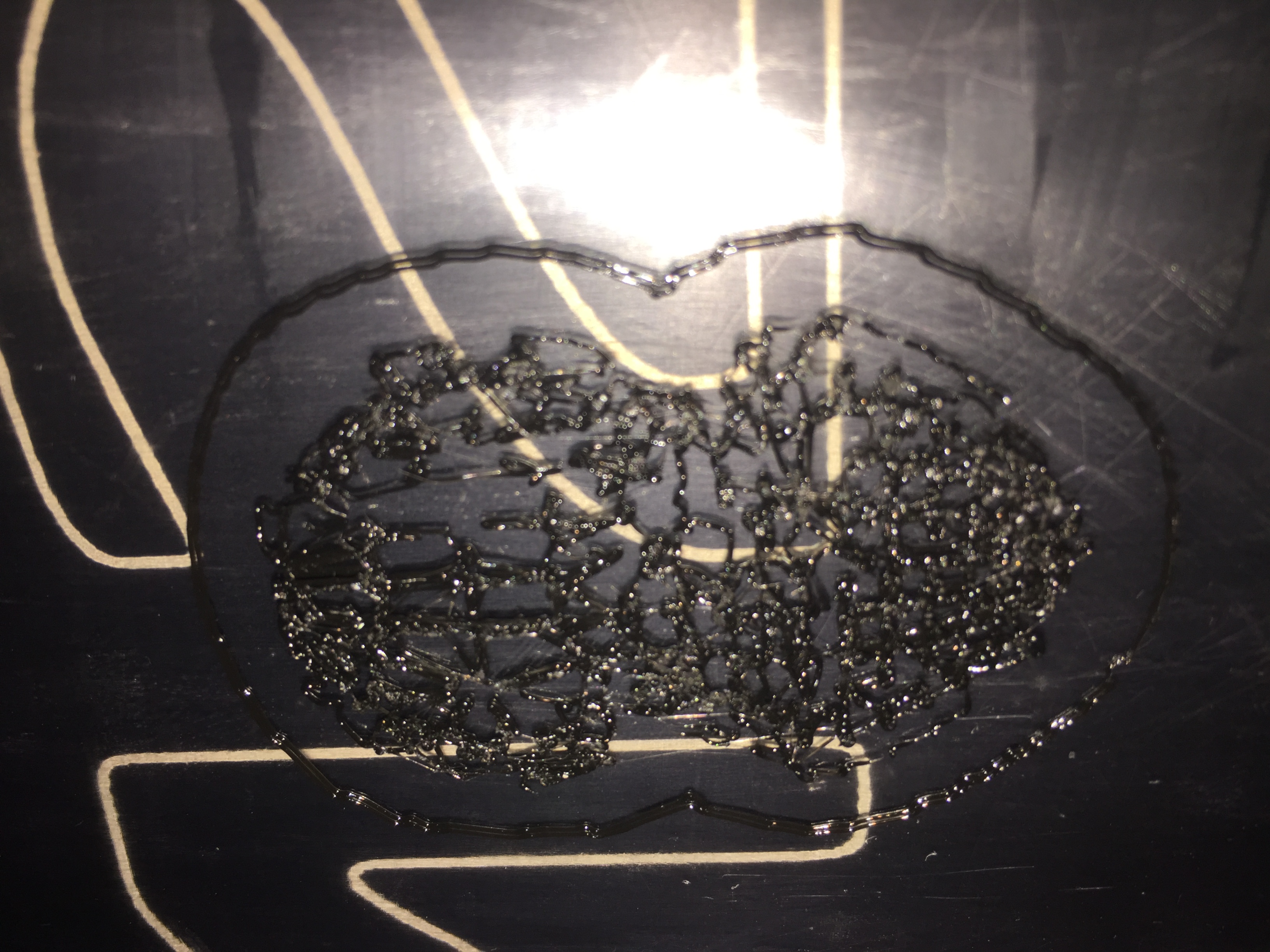

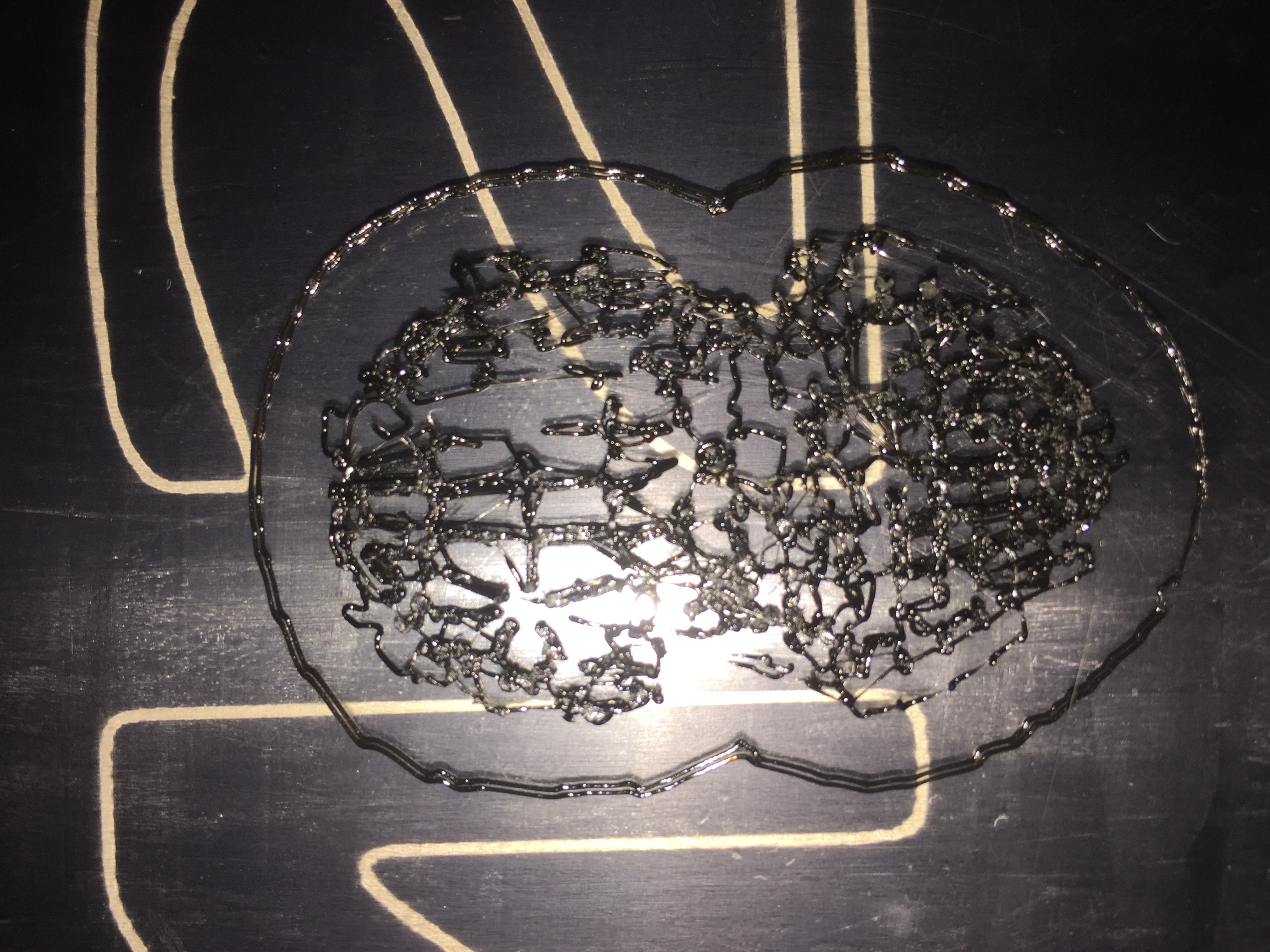

I'm using MakerGear M2 with v4 dual extruders and its not the Rev E. Machine. I'm only using extruder 0 (left extruder) and printing with PLA on glass bed with Elmers glue applied. My temperature settings are bed: 60 and extruder: 210. I have my left extruder selected only in my FFF settings on SIMPLIFY3D. The bed is leveled and extruder 1 (right extruder) is not hitting the build.
So why do keep getting the same results?

I need to see a close-up photo. Try to get one where we can see the individual threads.

I think she means close enough to see the individual lines extruded from the hot end. As in the plastic coming out as "thread".
By seeing close ups, it is possible to see if under or over extruding is happening. Also, judging by the shape of the skirt layers it is possible to see if the extruder is too close or too far from the bed.

And i would still like to see a close up of the photo that you have showing now.
It looks to me like you are too close to the bed with the nozzle for the first layer, but it's impossible to be sure without seeing a close-up of the print. And without being sure, we could give you directions that will make things even worse.
Re: Prints are still not sticking down.
You need to move the bed closer to the nozzle for the first layer. Right now it is air-printing, which means that the filament is just dropping onto the bed from too high, instead of being slightly squished into place on the plate.
Since you do not have a Rev. E machine, that means you need to either reset your Z-stop, and/or make an adjustment in the Simplify 3D software for the Z-Offset.
Your Z-stop is set pretty far away, and it would be a good idea for you to re-set it, BUT....it is also possible to just do a series of calibration squares to calculate a Z-Offset that you will need to use inside S3d to bring the bed closer for your first layer.

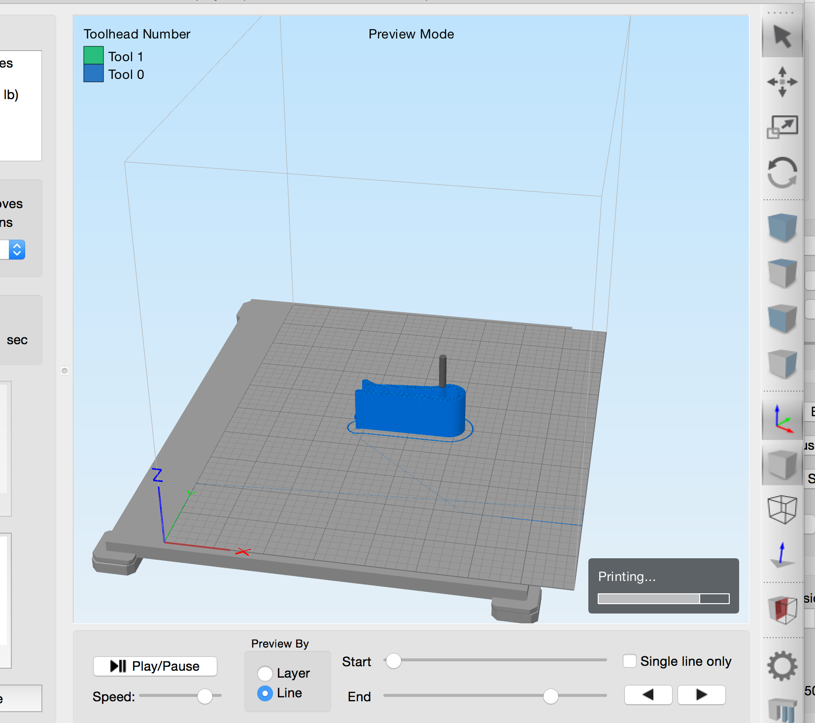

Is it suppose to be like this?
I did everything listed and the printer works great it printed out a money clip. On my simplify3D program my scale is moved over and it moved my print over as well on the bed. This is going to be a problem when I printer larger scale models. How do I correct this?
Thank you.
Thank you.
