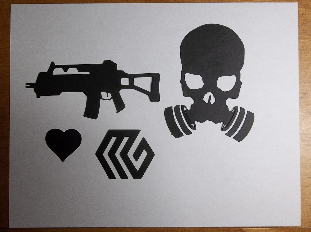

...but anything with small details like areas of the skull tore pretty easy while cutting and didn't stay stuck to the mat. I tried a thicker card type printer paper but that was even worse.
Switching over to a craft type card stock proved to be the winner, it cut out prefect shapes and even the little details stayed stuck to the adhesive mat.
Here's a few of the test cutouts. I think this would be good for cutting out stencils for things like airbrushing, I still have some more tests to run but I'm very happy with the final results on this attachment. The Blade/Holder and Mat ran me about $20. I'm not sure how long the Mats last but they came two to a pack so I still have a back up to play with if this one wears out to fast.

If you round the tight corners and S-curves in the file, they won't tear and pull up. Any time the blade is forced to do a rapid direction change it generally tears the paper instead of cutting it cleanly, particularly on loosely woven textured cardstock. (Vinyl cuts much easier.)
The mats can be washed!
Rinse in sudsy water, let it air dry. And if you want to renew the tackiness after a few washes - a light spray or two of Krylon Easy Tack Repositionable Spray Adhesive #7020 works to completely renew the surface. (And a can of that is about $8, and will refresh the mats until they fall apart.)

Thanks for that info Jules. I wasn't sure what to expect from these blades but they work pretty well even on the tight corners once I found the good paper. That's good to know about washing the mats and retacking them, that should save me money if it turns out I use this a lot.Jules wrote:Handy.....got a few of those.![]()
The mats can be washed!Rinse in sudsy water, let it air dry. And if you want to renew the tackiness after a few washes - a light spray or two of Krylon Easy Tack Repositionable Spray Adhesive #7020 works to completely renew the surface. (And a can of that is about $8, and will refresh the mats until they fall apart.)
