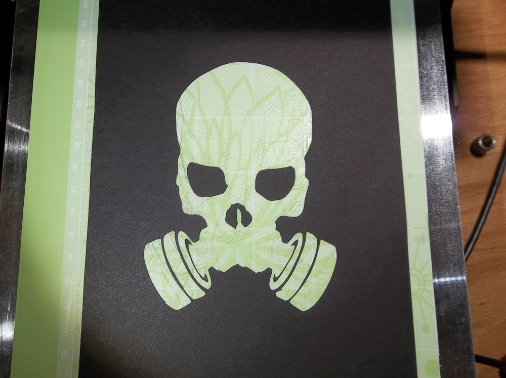

Initial tests with normal printer paper did ok....
...but anything with small details like areas of the skull tore pretty easy while cutting and didn't stay stuck to the mat. I tried a thicker card type printer paper but that was even worse.
Switching over to a craft type card stock proved to be the winner, it cut out prefect shapes and even the little details stayed stuck to the adhesive mat.
Here's a few of the test cutouts. I think this would be good for cutting out stencils for things like airbrushing, I still have some more tests to run but I'm very happy with the final results on this attachment. The Blade/Holder and Mat ran me about $20. I'm not sure how long the Mats last but they came two to a pack so I still have a back up to play with if this one wears out to fast.
