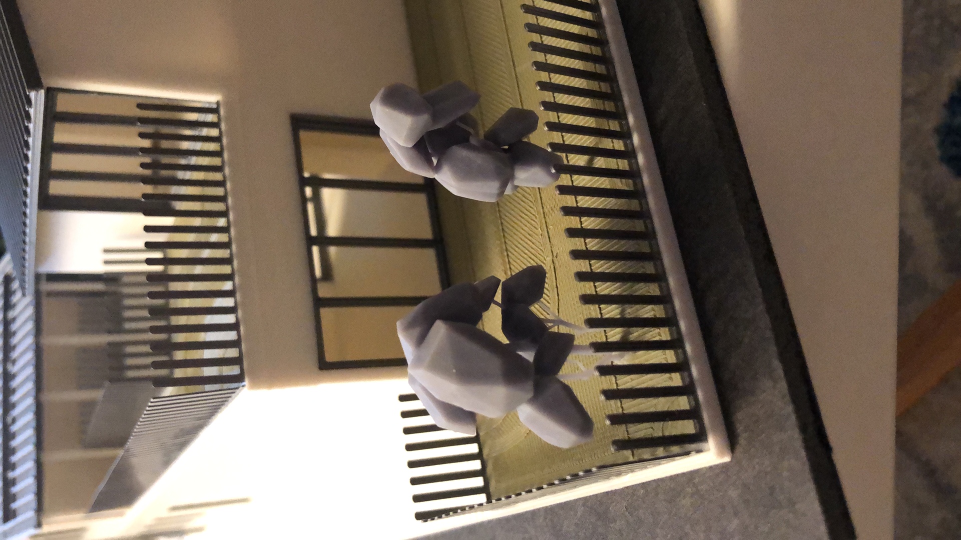

This is my latest model, and all floor are interlocking as you can see in the zoom of the roof for instance. There is a negative cut so it will sit on the wall perfectly without moving and without glue so people can open the model and see inside (and each floor does the same!)
building printed with nozzle 0.5 and windows/doors nozzle 0.35 (i own a nozzle 0.25 when they were still selling them because I thought it would be cool to print tiny details I used it once then went back to 0.35)

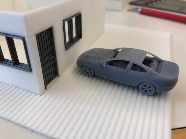

at the same time, I printed a car scale 1/64 (same scale of the model) with detail 0.05, yep 0.05, not 0.5!! with the DLP printer (DLP printer are super cheap!)
you just need to understand the limits of your machine and which machine is good for what.
Obviously, I could print the car with my M2-FDM, and I could use a 0.25, but I would still not have the right result and most probably a lot of problems
Other things that are better to print in DLP are for instance tree, persons and stairs... But I would never print the building in DLP is a waste of money resin cost more and it doesn't look as nice either as you have to divide it into million of parts and they are much more easy to deform

Added the second car and some detail I think printing a mix of the 2 technology is the best way I am in a site of DLP and I hate how they talk badly of FDM people is just weird

I'm curious - how long does it take to print one of those cars with your DLP? I also do human head models, around 75mm x 100mm, and I could obviously get much better detail with a DLP.

it's funny as DLP is so different then FDM so what matter is how "tall" the object is not how large so u can print 4 car in the same time as 1 if they are next to each other
but you have to print it with a slight angle I would say 4 hours at 0.05 and 10 hours at 0.02 (i tried to print at 0.02 and make really not much difference so I went back to print all at 0.05 or 0.04 if there is really some tiny detail 0.03 but so far I stick to 0.05 90% of the time)
https://www.thingiverse.com/thing:3489386
(this is the model of the house I just posted I uploaded it on thingiverse)
But remember of that house I only printed car and stair and tree on DLP all the rest that is very geometric even door and windows FDM is better because:
a) cheaper
b) faster (is not always faster but certain geometric shape FDM is faster)
c) stronger/precision of interlocking (the dlp have amazing detail but subject to bending and deforming so if it's a stand-alone piece great (car/tree) but windows that need to enter perfectly in the slot... not so much)
There are pro and cons on both you just need to use the right instrument for the right purpose
